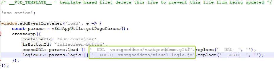

CustomerThanks for the reply, pushed that change to the file:
https://clients.dpipreview.nl/vastgoeddemo/vastgoeddemo.jsBut not loading yet https://renovatie.webflow.io/canvas
2023-09-27 at 12:47 pm #67161kdv
Participantbecause those files are not in the root directory
You are free to use a full path if you can’t use a relative one.
sceneURL: params.load || 'https://clients.dpipreview.nl/vastgoeddemo/vastgoeddemo.gltf', logicURL: params.logic || 'https://clients.dpipreview.nl/vastgoeddemo/visual_logic.js',
But most likely it will be a forbidden cross-origin access…
https://stackoverflow.com/questions/31276220/cors-header-access-control-allow-origin-missingJust put the
vastgoeddemo
folder to the same directory wherecanvas.html
is located and use a relative path to files. Or putcanvas.html
intohttps://clients.dpipreview.nl/vastgoeddemo/
and use this link https://clients.dpipreview.nl/vastgoeddemo/canvas.html and change nothing invastgoeddemo.js
