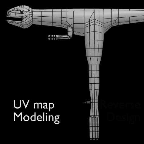

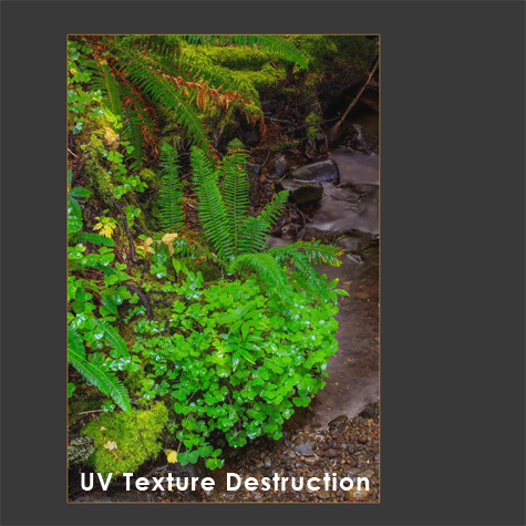

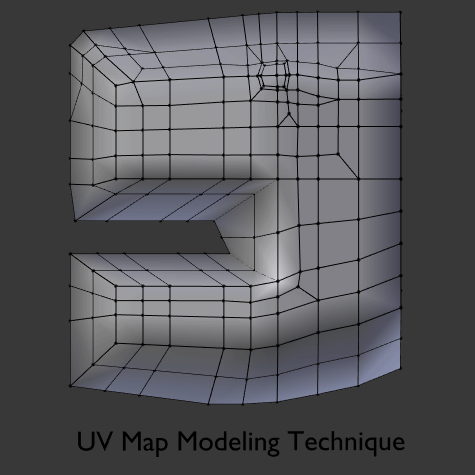

With this technique, I destroy the UV texture map and re-apply with my original file, even if the 3D model are stolen, the UV mesh is a mess.
– create a shape key in Blender, detach and randomize selected part of the model, create 2nd UV map with it.
– Duplicate the model, re-project (re-paint) the selected part from your original texture (or captured from the screen).
I will write to a well known Blender Guru to make a video later.
