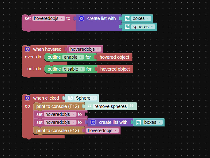

CrunchCustomerSo if I want to change which objects have a when hovered event, I always thought I just had to create a when hovered event using a list, then later when i modified what was in the list, the when hovered event would update?

CrunchCustomerSo correction.. In my first screenshot I wasn’t actually creating a proper list as I was using the group selector for boxes and spheres group. But.. as you guys pointed out, even if I brought in a proper list of objects, I can’t just quick reset it – rather, I need to remove items one by one.

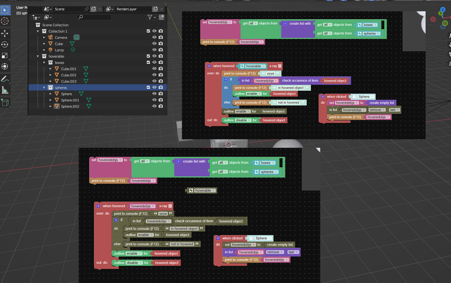

Then probably need to have the same type of iteration to add items back?Before I got the feedback and did come up with a workaround, where I move all possible objects I want to be hoverable go new collection in blender. Then in the hover puzzle, items that go into the on over slot are then filtered against my list before the desired effect is applied.
The list in this method, can be easily cleared at once, and reconstructed into list with get all objects from group puzzles.

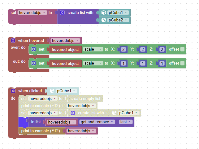

after this puzzle no objects will be triggered as hoveredGive more details. Why do you click the sphere? What do you want to get? To remove outlines or just reset the hovered objects list? Or do you want to remove the clicked object from that list?

CrunchCustomer“you can – after this puzzle no objects will be triggered as hovered”
umm.. Not sure about that. Pretty sure that is how it use to work.. but now (latest 4.3 version) doesn’t seem you can just clear the list.. my testing shows that list needs to be cleared 1 item at a time via the ‘remove from list’ puzzle.
