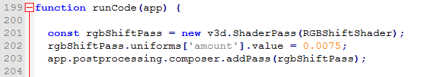

    (mainly focused on RGBShiftShader)
    That’s all. Just 4 lines of code needed in this case…
    https://v3d.net/i2l
    #63166
    Johnson
    https://v3d.net/i2l
    Thank you so much kdv! I really appreciate that– this made my day!!! :yahoo:
