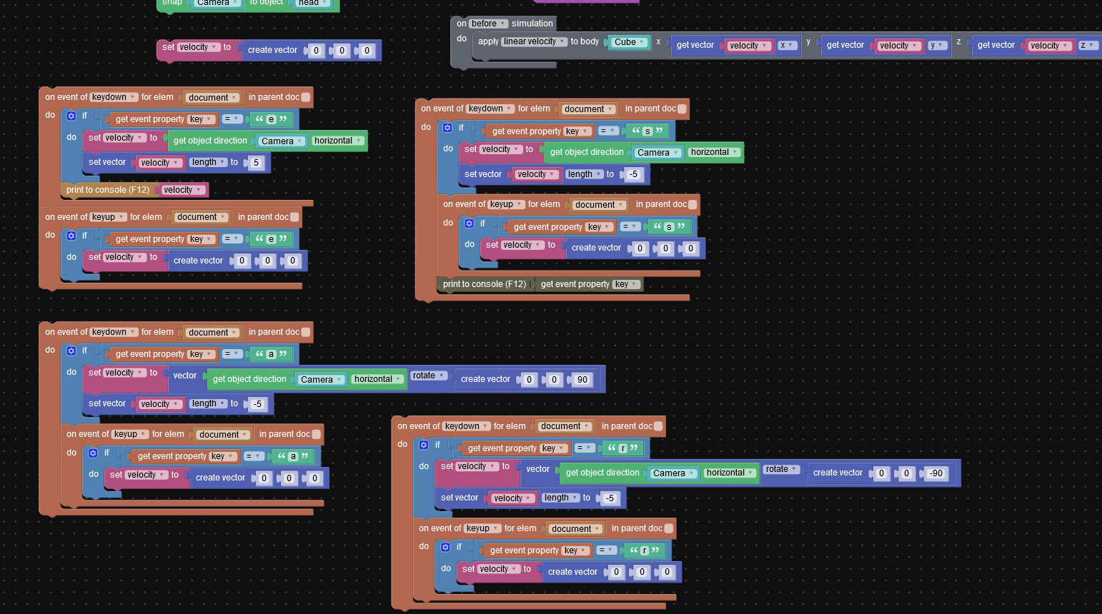

    Anyone have a basic setup for a physics based FPS setup I could take a look at?
    The Verge guide has this teaser which only codes ArrowUP
    https://www.soft8soft.com/docs/manual/en/introduction/Physics-Guide.html
    I gave it a go (see screenshot) adding the other directions (back, left/right strafe) but don’t think I did it right??

    #33607
    we’ll definitely think about create a template or a demo on first-person controls with physics. :yes:
    In the meantime, you can play with our internal demo called Cube VR. Click on the big FPS text to enable first-person controls.
