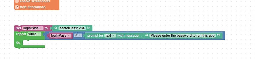

PandernCustomerThe absolute most basic way to do it could be to use the
user promptto ask for the password stored in a variable in the init tab of the puzzles.You can extend it to store the password on the users computer and even extend it to also ask for a user name first. Let me know if you would like help with that.

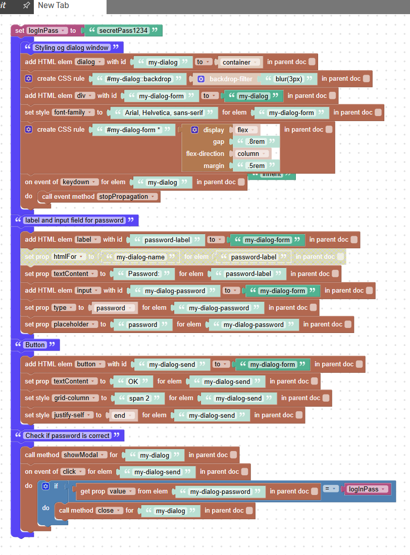

The html
inputtypepasswordis hiding the text by default and can be further styled.By changing the
enquiry formfound in puzzle library in verge3d, i quickly made this:password: secretPass1234
see the puzzles in attached screengrab.
It is a very rudimently styled and made, but it may be a good start for you

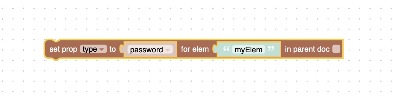

2024-12-16 at 5:35 pm #79422bigmike814
ParticipantI would worry more about the password being stored on the client side than seeing it on the screen. If it were me I’d use server side validation. You can do this by using the advanced puzzles and some server side php. If you’re only doing a few users then json will work. If you’re allowing users to create their account and then log in later you’ll need to set up a database.
Anyway, I didn’t try this but this should give you your answer (see image). Here is the documentation as well. https://developer.mozilla.org/en-US/docs/Web/HTML/Element/input/password

PandernCustomerI would worry more about the password being stored on the client side than seeing it on the screen. If it were me I’d use server side validation. You can do this by using the advanced puzzles and some server side php. If you’re only doing a few users then json will work. If you’re allowing users to create their account and then log in later you’ll need to set up a database.
Certainly, BigMike! On an open or public site, user credentials like usernames and passwords should always be stored server-side, as you mentioned, rather than on the client side.
Saurav had asked for an example, so I provided the simplest one that came to mind.
The example I shared is from an in-house configurator that only required basic accessibility, as it’s sold to clients as a SaaS product with per-user licensing. The username is also used in the PDF/image uotput from the configurator.
I should have clarified this. Regardless of how and where the passwords are stored, the example puzzles I shared remain largely the same, with only minor changes depending on how the credentials are retrieved.
The modal dialog in my example uses the password input type you referenced, but I appreciate the additional resources you linked—thank you!
Lastly, the modal dialog also addresses the original poster’s (vizualizer’s) request: to create a window or pop-up that appears when a 3D item is clicked, prompting the user for a password to continue the 3D experience within the app.
