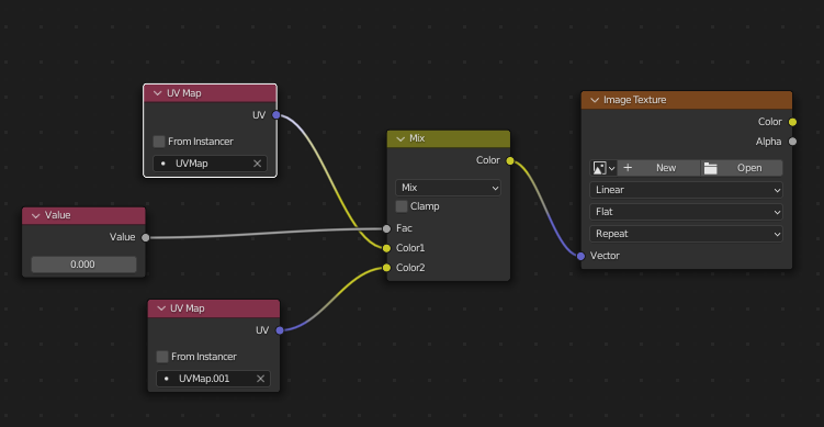

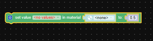

    You can use this setup with Set Value puzzle to switch between them.

    eeey
    Thank you!!! :yahoo:
