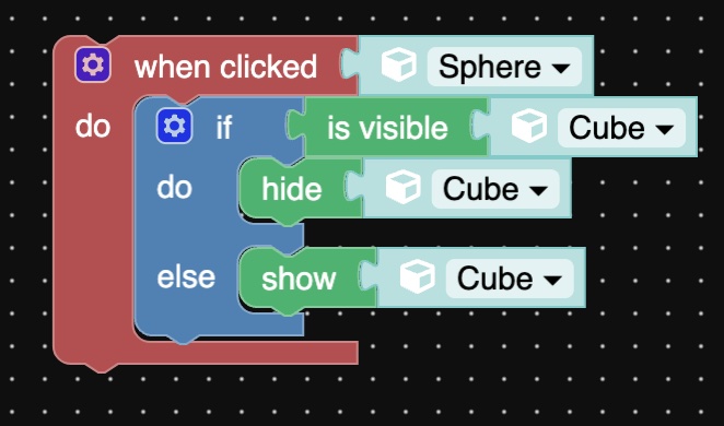

xeonCustomerThe below image is a super simplified way to use hide/show.
Create a scene with a cube and a sphere, so that each object is outside of the other, no interference. Add the below puzzle and you can click on the sphere and see how it hides the cube.With respect to loading and unloading a gltf…take a look at https://cdn.soft8soft.com/demo_pre/blender/load_unload/load_unload.html

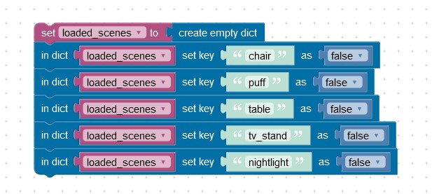

I tried the first idea but I need to have them all in the same place.
I then tried the second idea and changed the nightlight.blend to have my model instead of the nightlight model and got that to work by using 15Plus_base and in the upload.blend file I used 15Plus_place.
When I click on the drop down for nightlight I get my model.In the puzzles below. When I change the nightlight to my file name 15Plus it doesn’t work.
I took the nightlight.blend file and saved it also as 15Plus.blend and exported them. It also never shows up in that drop down with my name even though I changed it in puzzles and also left nightlight there as well.Last question then I will be using woocommerce with verge3d plugin. Should I get the drop down to work or because I am using woocommerce I would think I need to something else in the puzzles. I understand I need the connection puzzles for woo but need help understanding what I need to use there to get my woo dropdown to work. Or is this just not possible.
