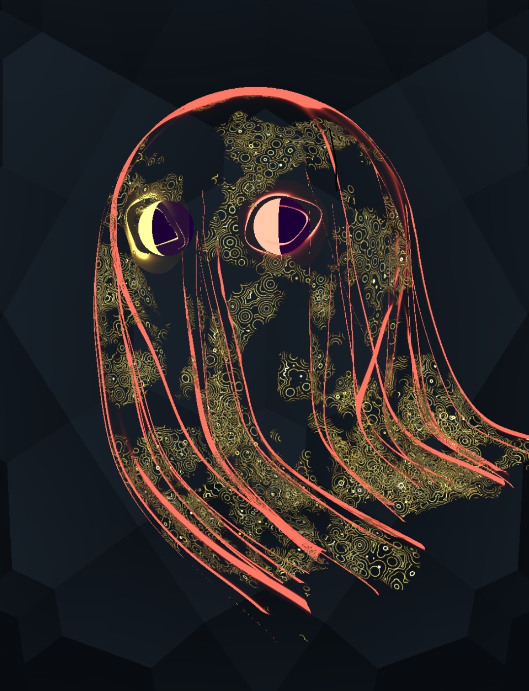

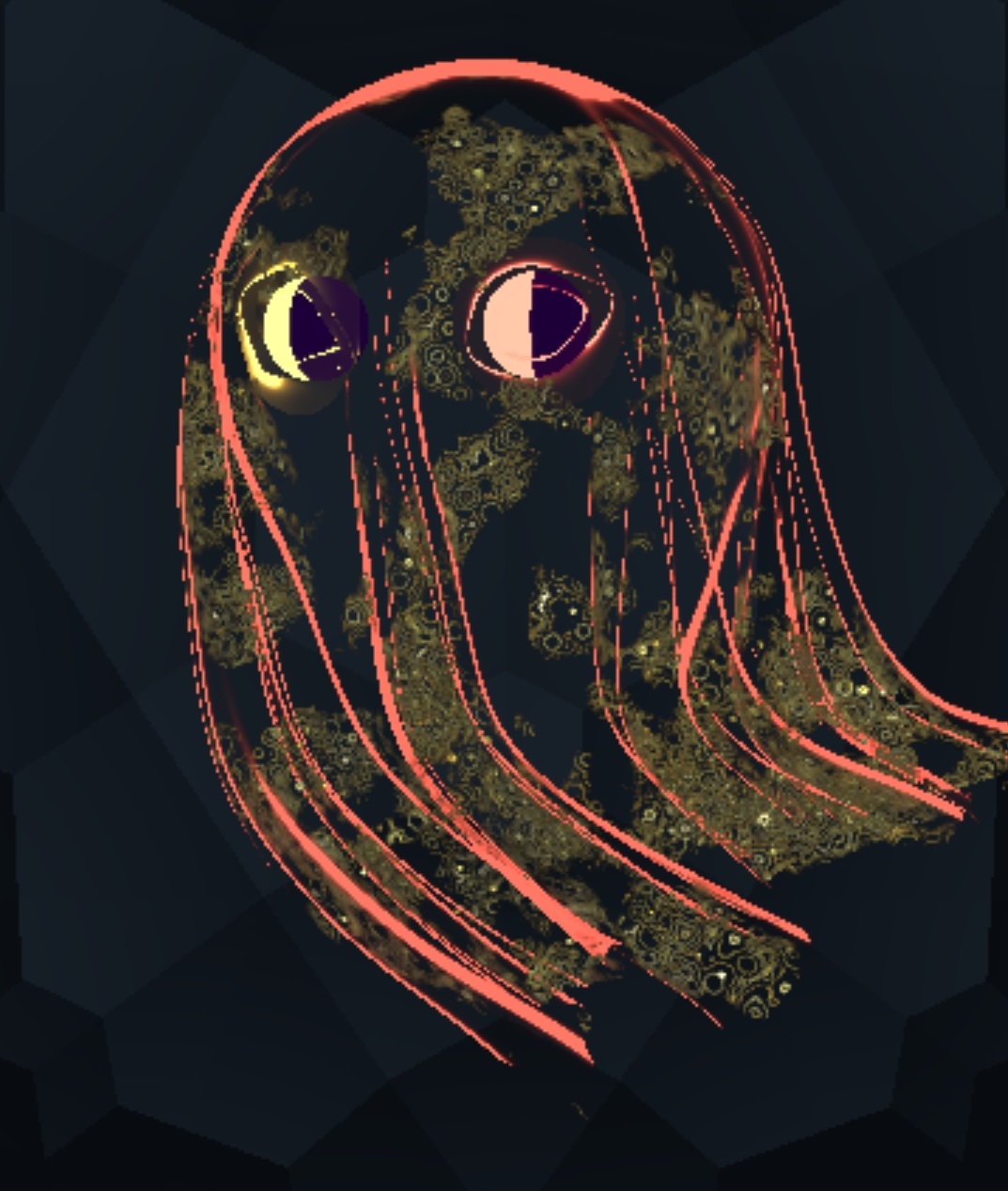

    Hi verge3d community,
    On desktop i’ve no issue, but while displaying my scene on mobile device i have a lot of aliasing and bloom effect is turn off.
    When i force my mobile browser to run in desktop mode, i don’t have issue with aliasing unless if i switch to fullscreen mode..bloom effect still doesn’t work.
    I’m using one 8196×8196 texture, anisotropic filtering set to x16 in blender.
    In puzzle i only have bloom effect and setscreenscale to native mode, seems like this one don’t change anything.
    Thanks by advance. =)

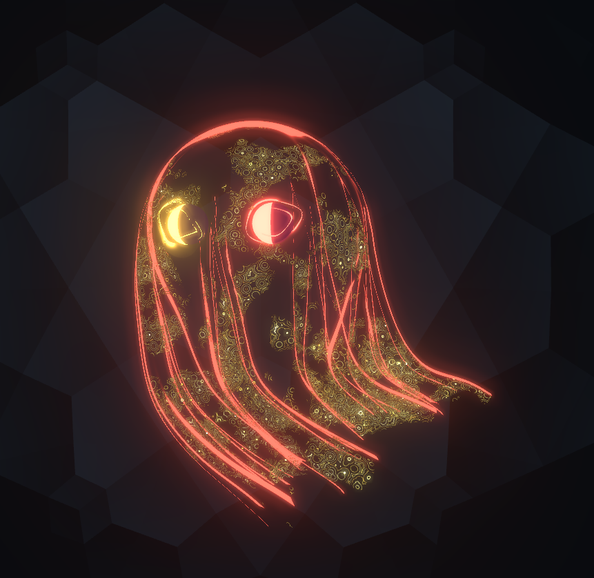

    Verge3D 3.7, i did some changes in my puzzle code, following the same than swiss army knife, and it work! =)
    I have bloom now, and less aliasing on mobile with enable/disable rendering puzzle, aliasing is due to emit fresnel too thin on the edges i think.
    #43085
    Some mobile devices may not support HDRI rendering so bloom ellefct will may not work if threshold too height, otherwise if you set it low it will bloom even gray (lower 1.0 brightness) colors.
