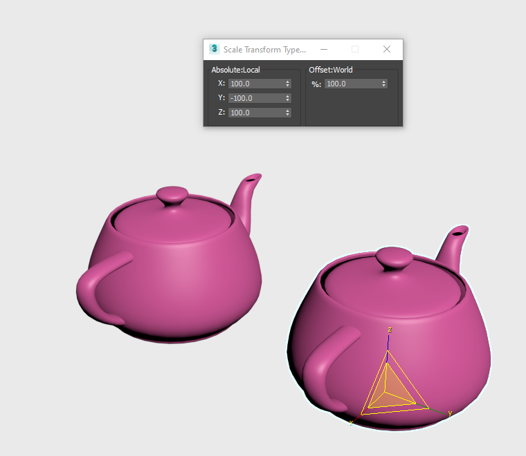

    I’m having a hard time with 3d objects which are mirrored in 3ds max. When I scatter objects which are getting randomly flipped, verge is displaying them in a black shade which is semi transparant. Is there anything to change that behaviour in verge3d?

    Sure, but you can reproduce it pretty quickly. Take any geometry, create an instance and then mirror that instance with the default settings.

    The pot has – Y scale set it to positive, the engine wont properly recalculate – scales.

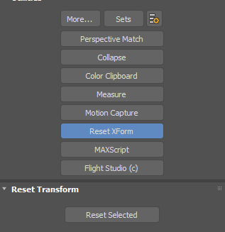

    Try to reset xform for this object before export.

    I know about xForm but this destroys the instance. I would like to keep the instancing.
