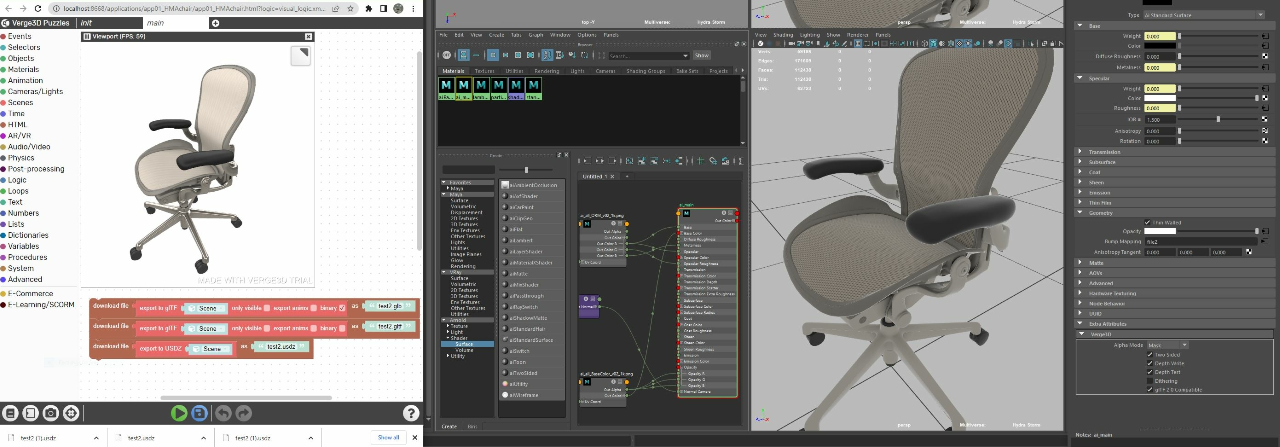

    I have this chair model that needs to export glTF2.0 compatible glb files but it has been failing every time, the usdz export works great. After testing 100 features it seems that disconnecting R output to AiStandard Specular fixes it and allows for export of glb. So it seems that the single channel of an ORM texture can only be connected to one input attribute and not two?
    Will test this on a sphere, but this seems to be a new problem as I have exported the 2.0 glb files before using puzzles. Using the new Verge3D v4.0.1, and Maya2020.

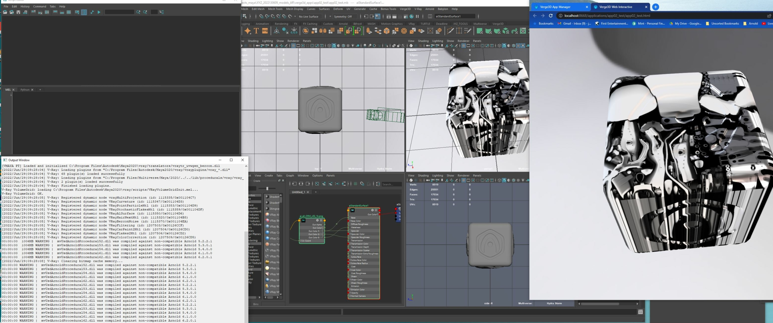

    I did watch for messages in the output window and script editor, but there was no information, here is a screen grab. Today I will try this again with Maya Standard Surface instead.
