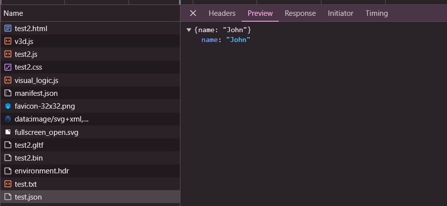

justin_blenderCustomerHello,
I have a very simple “load data” of a json file. It works fine on the virtual server of Verge3D. But once I upload the project to a webserver, the loading does not work anymore. In the Network Tab I can see that the file gets loaded successfully. It is a pretty normal Apache Server, nothing special.
https://simulux.de/dev/3D/test2/test2.html
Console log:
visual_logic.js:157 puzzle load file: Cannot read properties of null (reading 'startsWith') loadFile @ visual_logic.js:157 await in loadFile PL.init @ visual_logic.js:168 (anonymous) @ test2.js:53 (anonymous) @ v3d.js:1 (...)I uploaded the project to the v3d net and no problem there

justin_blenderCustomerThanks for your suggestions!
I added the MIME Type, but it did not help.
I am not sure if that is the problem, as the Network tab is showing the JSON content correctly (see screenshot of first post) – and the problem comes from the visual_logic.js.I can load txt files, but I cannot process them as a dict in Puzzles
