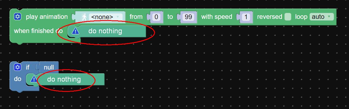

    I always think if there is any chance of having a puzzle “do nothing”
    many times I felt as if this puzzle or such provision is there then the logic setup would be more fool proof.
    in my perspective there would be two functional meaning for this tiny puzzle asper its name
    1. Literally do nothing after a specific condition is checked or tested.
    2. Do not allow anything else while specific process or action is happening in the scene.
    The second one sounds more useful especially while some thing is happening and users unwanted / unintentional click not to disturb the scene in to chaos till the initiated process completes.
    #72368
    Hi visualizer,
    You can just leave the slot empty – or create an empty procedure called ‘do nothing’ and invoke it. :good:
    #72369
    “do nothing” is the default action :scratch: no puzzles = “do nothing”

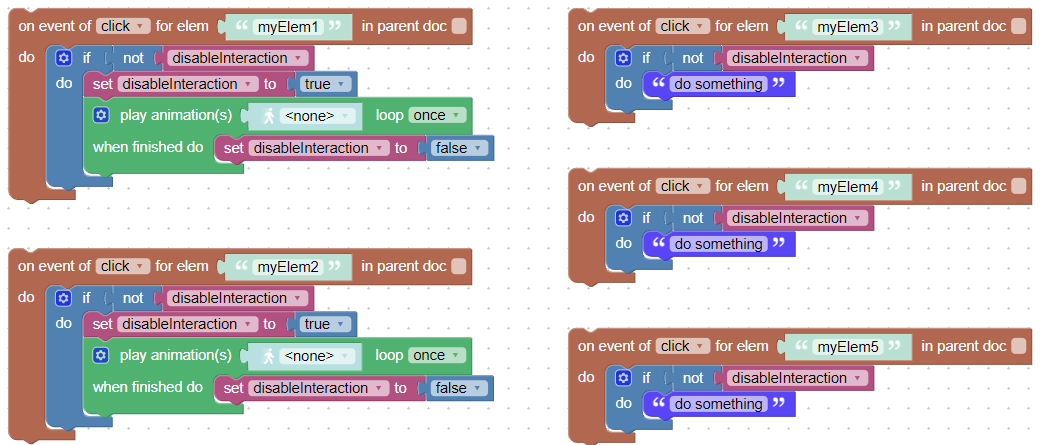

    How to achieve the point 2 in case if it is required?
    Example – in case of robotic action ( or any such action ) once started, user’s any click should be prevented from any actions to happen in between. Till the triggered process completes.
    how to achieve this?
    #72378
    With the help of simple logic
    #72409
