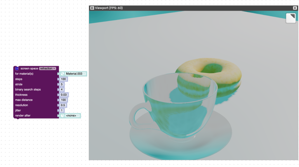

    #45975
    Now that you got this far…. open up the Post-Process Screen Space Reflection puzzle and switch it over to Screen Space Refraction.
    And give that a whirl should let you get much closer.
    #45976
    Here is a crude test…but it illustrates what can achieve. I didn’t spend any time making it look pretty just showing you can get some refraction if needed.
