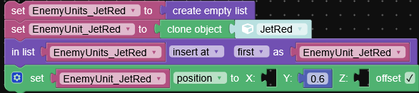

    I know how to clone objects, and AFAIK, cloned objects also inherit the puzzles of the original.
    Now, I’m trying to make individual cloned objects disappear when they get touched by a sphere. How do I make each individual clone disappear when it touches the sphere? I won’t be using any click function for this.

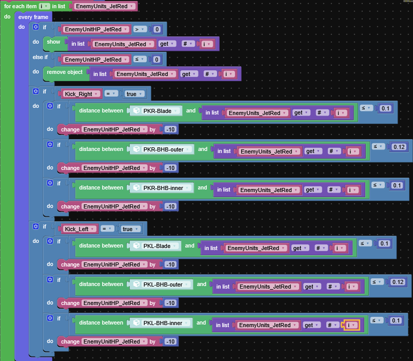

    I’ll look into your suggestion about physics for sure. Here, I’m trying to remove individual clones of a puzzle’d object, when another object comes into contact; especially via loops:
    #69329
    bigmike814
    having the distance on there set to zero means that unless the origins are in the same spot it won’t work. If you increase your distance margin some it should work, considering everything else is set up correctly.
