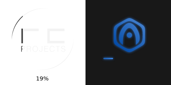

CustomerYes but not the custom preloader…
2020-10-15 at 1:51 pm #34222
Yuri KovelenovStaff2020-10-15 at 2:04 pm #34226albertgavalda
CustomerYes correct, the white one is my custom one, and the black one is the verge3d. I followed the tutorial on your channel about how to change the preloader and I ended up with this issue that I don’t understand because I’m not used to making websites. I dont understand why in “myprojectnam.html” the preloader appears but not the footer icons and on the other hand in the idex.html the footer icons appear but the preloader doesn’t. Could I have a bit of an insight on how this works please?

Yuri KovelenovStaffAh, I see. This is easy – your app now consists of 2 html files. Forget about “myprojectnam.html” – it is now irrelevant. The correct file for linking is “index.html”.
Here is more about this: https://www.soft8soft.com/docs/manual/en/introduction/HTML-based-user-interfaces.html
