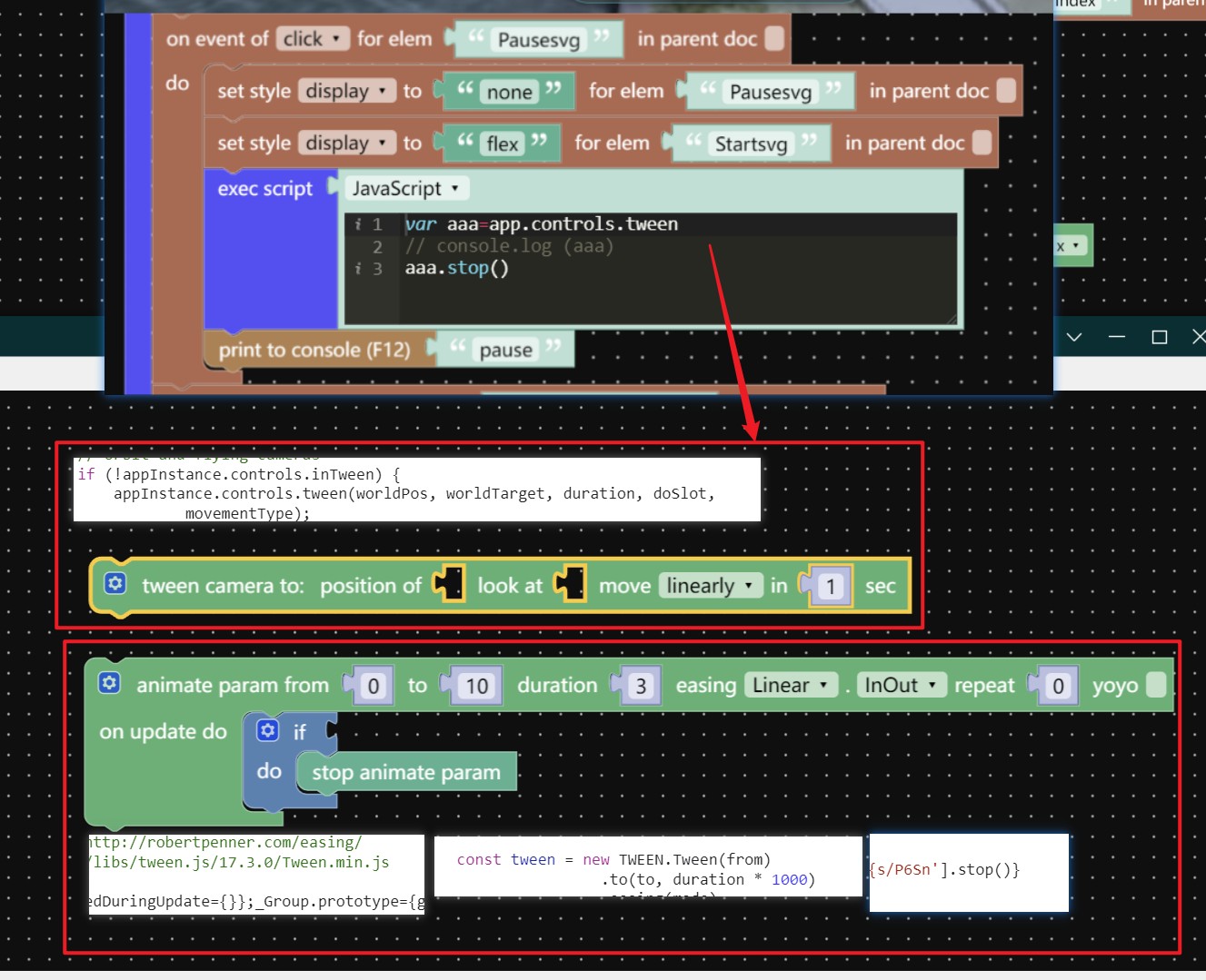

    I am working on a camera roaming interface and I have added a pause button. However, I can’t find a method to pause the animation. Through backend logging, I discovered that the camera animation I’m using is app.control.itween(), and it does not utilize tween.js, which provides a .stop() method. I’m wondering if orbit.control has not defined or provided a similar .stop() method? Any advice or suggestions would be greatly appreciated. Thank you.

    I am interested to see if anyone has a solution to this based on JS.
    Another approach would be to change your camera rig in blender.
    You would want to have the camera attached to an empty that is the “look at target”.
    Basically place the empty where you want the camera to be looking.
    Once you have this you can move / animate the camera object and the associated empty without using tween. By doing this you can interrupt the animation sequence.
    I have not found any way to interrupt a camera tween yet. Would be nice if we could.

    As a variant, do not use tween camera, use animate param instead.

    I’ve used an animation with an extremely small distance and a duration of zero as a workaround to stop the animation, which has solved the issue mentioned above. Thank you.
    This single line of code will interrupt tweening at any moment.
    https://v3d.net/lf3
