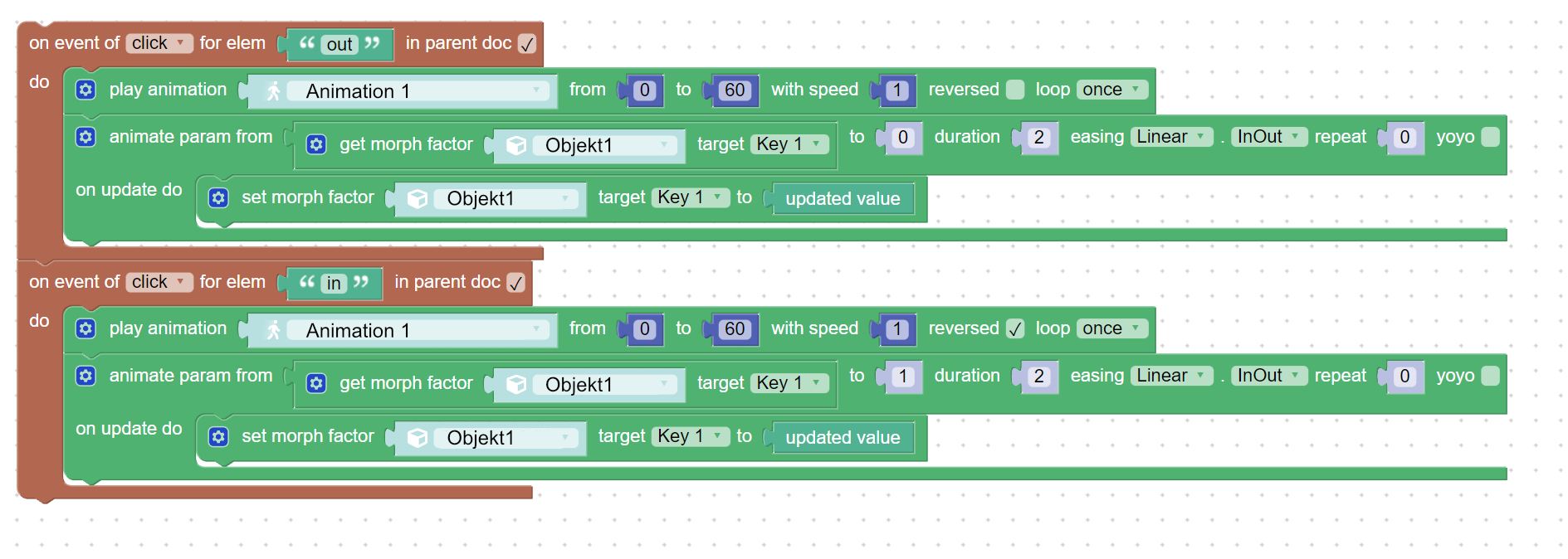

CustomerHello,
Is this now possible to do with puzzles? I need exactly the same. I got a structure which flips open and can be closed again with two HTML buttons. For the shape key object it works perfectly. Just need it for the animated object.Please see the screenshot attached.
Thank You!
2022-08-22 at 2:07 pm #55094kdv
ParticipantUse the
get animation framepuzzle to set the last frame in the reversed animation or the first frame in the direct animation.Puzzles and JS coding. Fast and expensive.
2022-08-22 at 2:34 pm #55095fred7
CustomerMany thanks! Tried that puzzle before, but did put it wrong.
