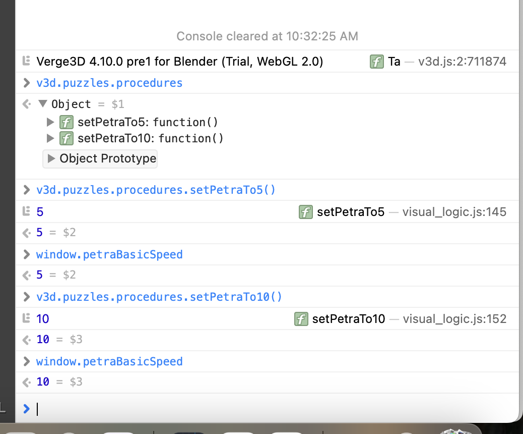

    On the first response:
    look up v3d.puzzles.procedures and it will give you a list of all the procedures. You can call one of them by typing v3d.puzzles.procedures.theNameOfTheProcedureYouWantToCall
    you don’t want to try setting anything to the window with v3d.puzzles.procedures.window…
    To set a window object/key you just set window.PetraBasicMove = 12 since you defined this to the window and use it in your procedure, you can set the move rate
    and then call the function (procedure) that calls the movement.
    v3d.puzzles.procedure.movePetra if your function is not setting the speed it uses then it will change the speed.
    It’s really hard without seeing what exactly you are trying to accomplish, but just trying to help you understand the concepts.
    You have to re-fire the procedure or it wont change.

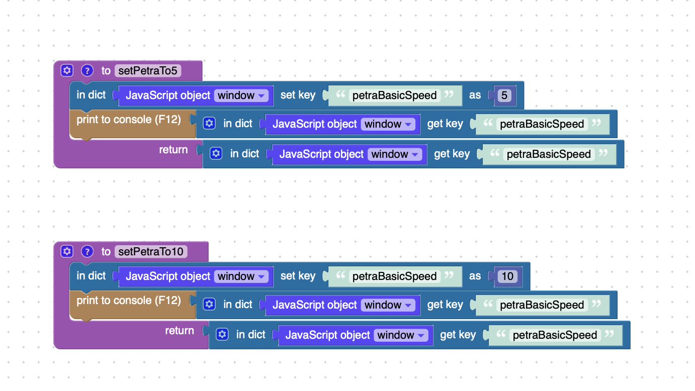

    here are some screenshots of a simple example to conceptualize it.

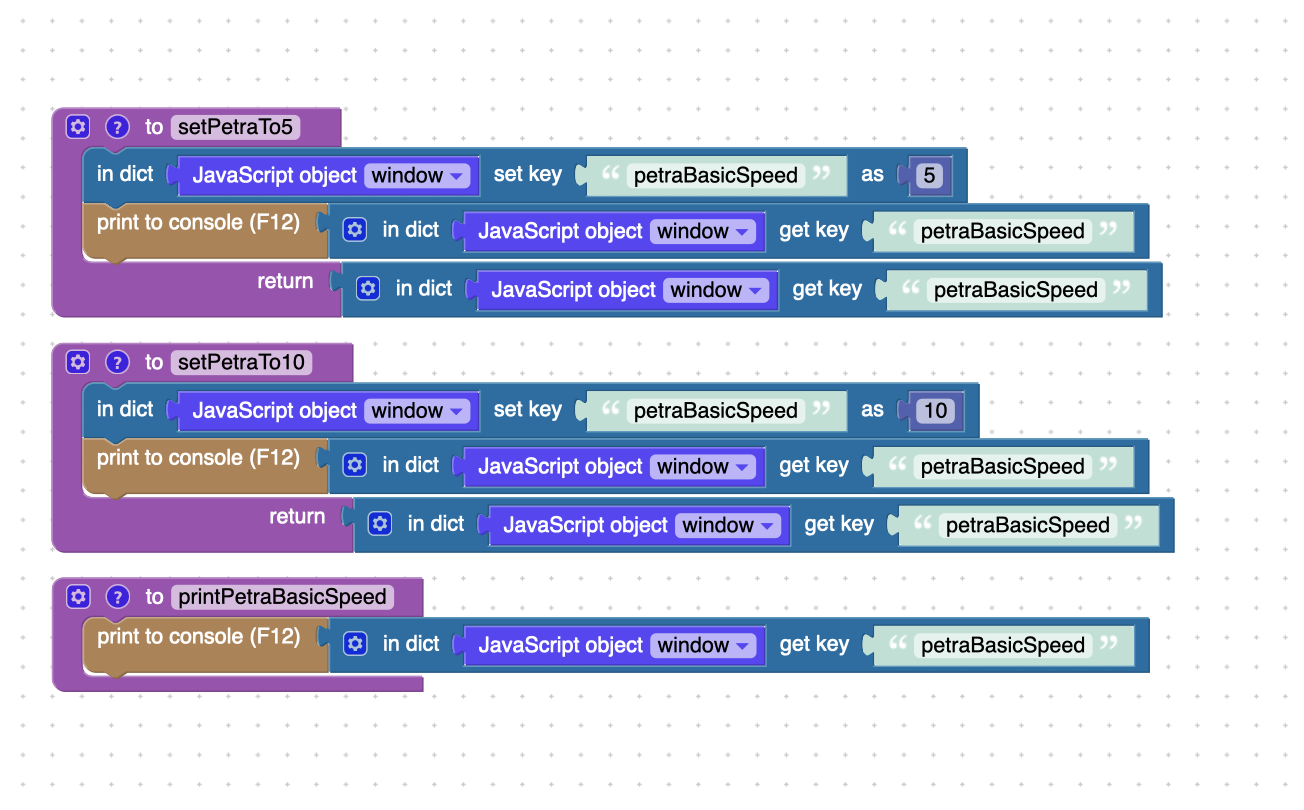

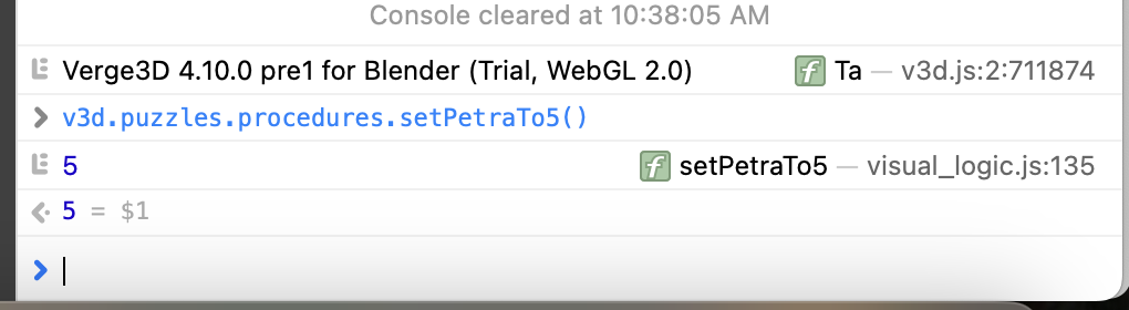

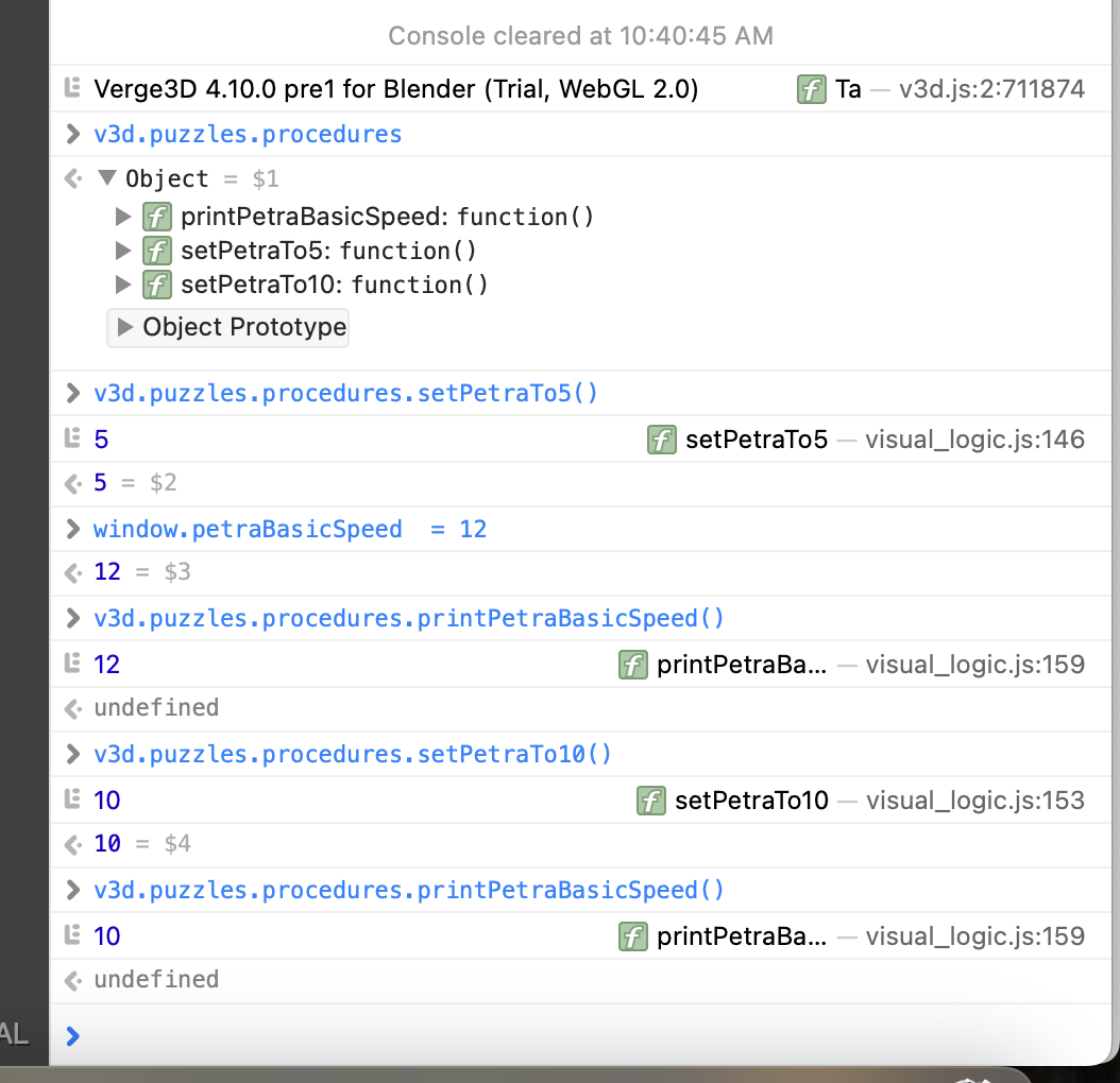

    Here is another example on how to set the window key petraBasicSpeed value to 12 from the console and then you have two functions that you can call to set it to the defined amount.
    Hope this helps
