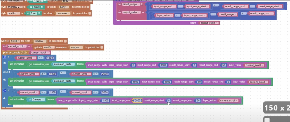

    I’m looking to make a scroll interaction that affects the keyframes of an object or camera as I scroll down and up a page. This is similar to this tutorial (https://youtu.be/G2rVV8dAmCU), however I would like the trigger of the interaction to be a ‘div’ or ‘section’ on my Webflow website as opposed to scrolling within the iframe.
    The attached image is how the tutorial set up the puzzles.

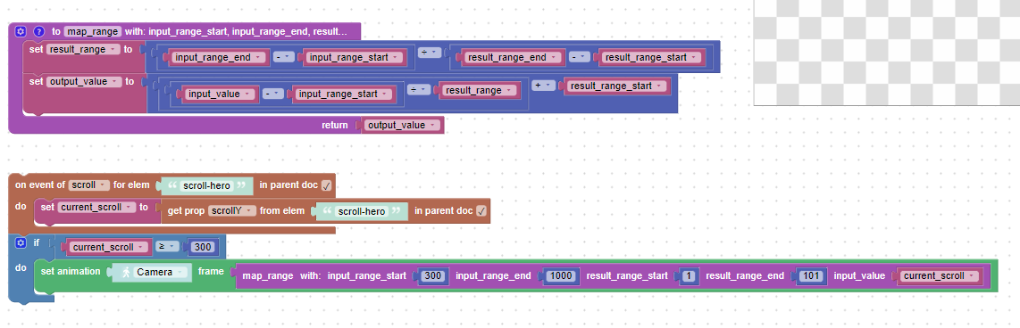

    Then instead of taking scroll position from iframe you needto take it from needed div with a specific ID.

    So I gave the parent div an id of “scroll-hero” and a height of 1000px, and then made the puzzles as shown, and it doesn’t seem to be correctly moving the camera with its keyframes.
    #47432
    May be there’s a different input range check it by printing it in console.

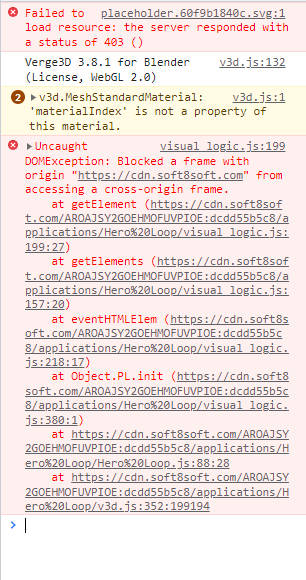

    The attached image is the console error I receive. Nothing is being to the console. Are there any compatibility issues with Webflow sites?
