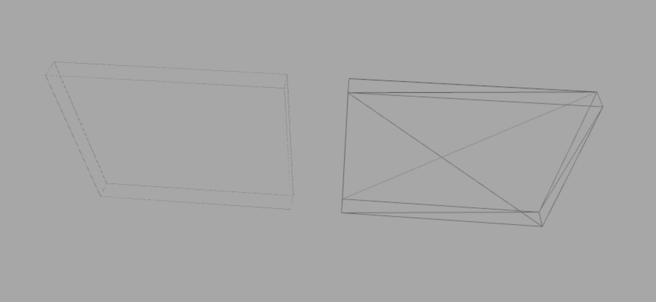

ParticipantIn my project, It works differently when I use ”Line rendering”setting & “enable wireframe for Materior “, and in my opinion ”Line rendering” is better.

"meshes": [{ "extensions": { "S8S_v3d_mesh": { "colorLayers": {}, <strong> "lineColor": [0,0,0],</strong> <strong> "lineWidth": 5.0,</strong> "uvLayers": {} } }, "name": ..., "primitives": [{ ... } ] } ],2023-10-11 at 7:27 am #67469kdv
Participantand in my opinion ”Line rendering” is better.
Yes, it looks better (no triangulation, lines thickness can be set to more than 1px) and it can be activated only in 3D editor before exporting. You can’t do it with puzzles.
