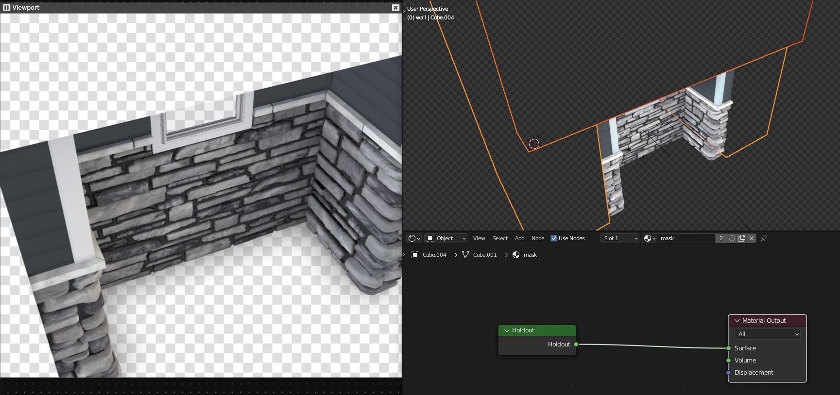

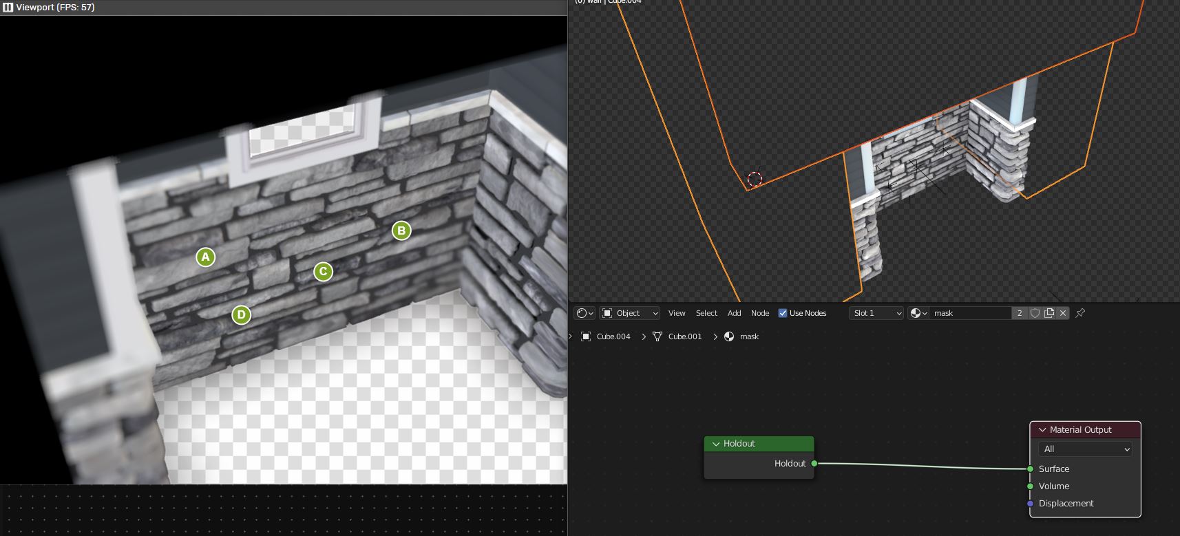

    When I update verge (specifically the v3d.js file) to the latest version 4.2.0. The Holdout node appears black. (see attachments)
    Also here is a working example of what I have done in the past:
    https://www.provia.com/wp-content/uploads/verge3d/56256/index.html

    the last version where the holdout shader was working as expected is 3.9.1. Sneak peek (latest addon) shows the black color with all v3d.js begining from 4.0.0 and works fine with v3d.js 3.9.1

    3.9.1 ultimate, 4.0.0_pre3 ultimate
    4.0.1+ working wrong way
    Opaque
    Alpha Blend
    P.S. 3.9.1 for Blender shows two black cubes ))) It works as expected only with non-obfuscated 3.9.1 ultimate and 4.0.0_pre3 ultimate.
