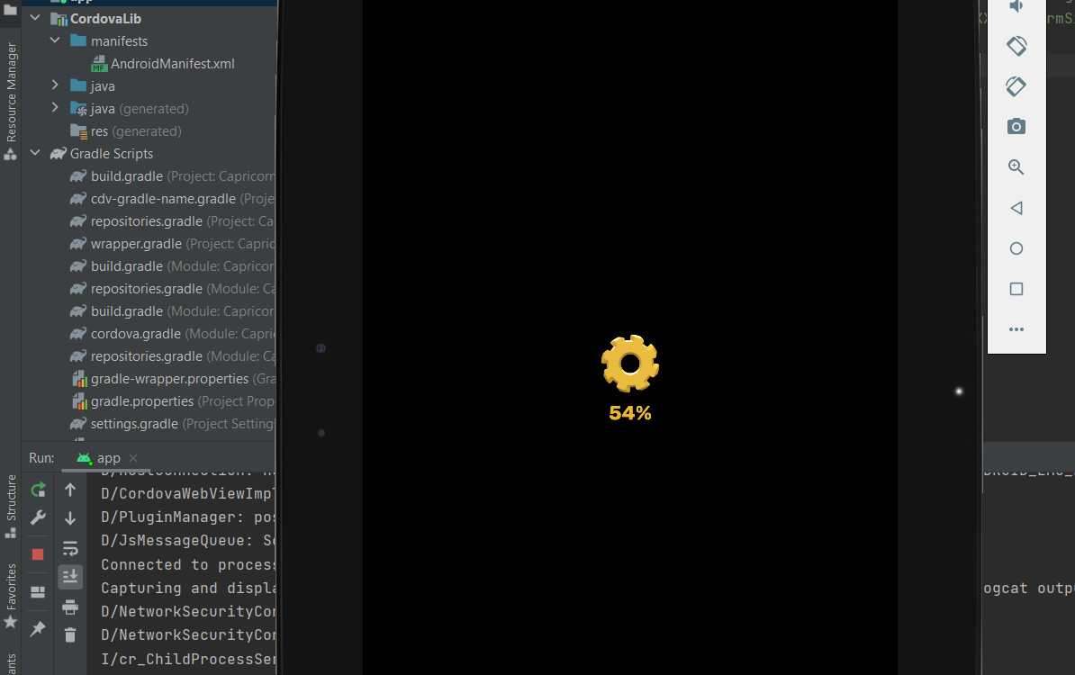

    I’ve been unsuccessfully trying to create a working Mobile app, from the workflow proposed in the Verge3d manual. I successfully, created an apk file but I’m unable to load it in the emulator. The file stops loading at roughly 50% and crashes. I have the same result while installing the file in my android phone. The apk file is roughly 2.5 GB.

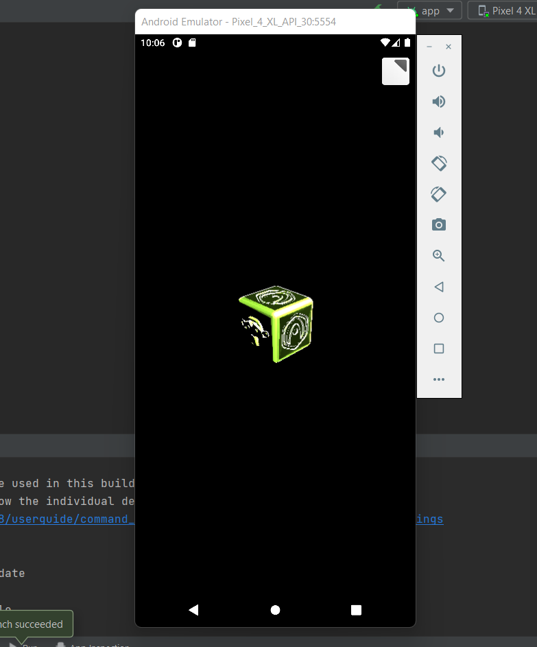

    I successfully created an apk file based on the smaller scene as suggested. I also attached the apk file of my big scene.
    Again, the desktop application created from my big scene works great. I just have issues with the Mobile app version of it.
