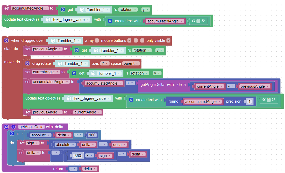

    If you have ever run into the situation where the rotational values from the Get Object Rotation are 0 to 180 or -180 to 0 and you need the values to be 0 to 360, this handy QuickTip will give you a procedure you will find very useful.
    Watch it here its less than 1 minute in length.
    or for more detail, project file and blender file go to:
    https://www.xeons3dlab.com/post/verge3d-360-degree-rotation
    #71877
    Math and logic can be a little less complicated than you imagine :-)
