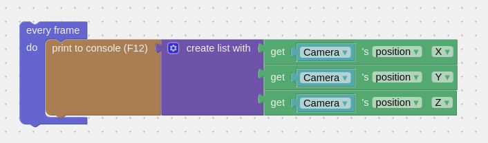

The camera actually dollies – you can see how its coordinates change with some puzzles.

Most of my apps I use a no-control cam that is perpendicular to my scene. To get a mouse wheel zoom, I usually add some type of contraption like the one in the screenshot attached (which works off camera animations). But it always sucks. Never as smooth or as responsive as with the built version to the orbit cam.
If I could get the code or a way to replicate zoom on non-control cam that would be great, thanks!
