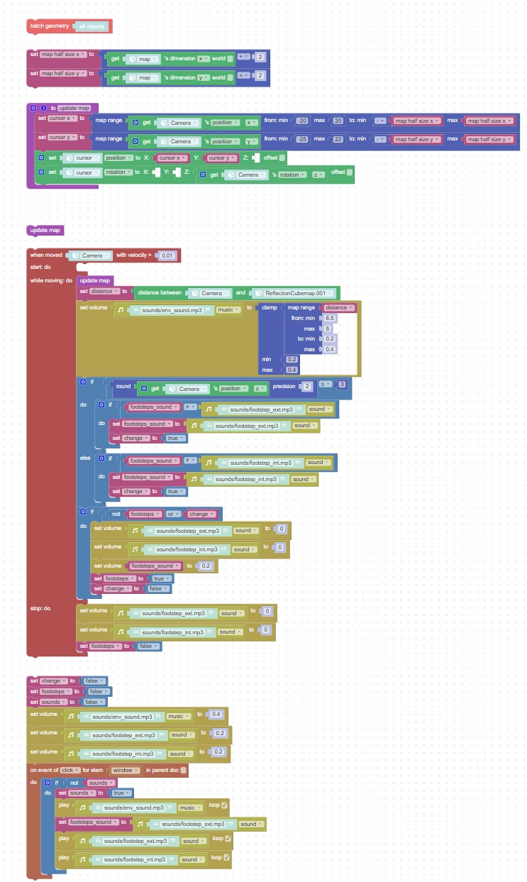

    I am wondering how there are no any physics OR VR related puzzles set & I thought its not compatible with VR. what all it has in puzzles is this in screenshot.
    How it is still working without any workout of puzzles? am I missing anything again?

    First Person controls + collision mesh (in Blender). That”s how it’s walking. No puzzles are needed for wolking with WASD in browsers.

    How come it is also working in VR then?
    With the help of puzzles from the built-in library. The First Person controls are not used at all when your are in VR. Puzzles only.
    How come a stair case climbing is working ok?
    It’s implemented in v3d.js. The Orbit, Flying and First Person controls need no puzzles to work as expected. Collisions for the First Person controls are also implemented in v3d.js. But they are supposed to work and do it in browsers only. Not in VR.
