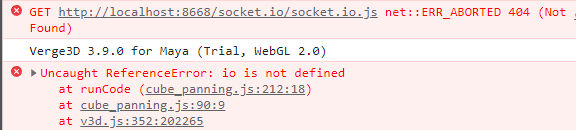

ParticipantIt’s not a problem of Verge3D… Does
socket.emitwork as supposed to work?
You have this string in the html file
<script src="/socket.io/socket.io.js"></script>
But there is no such folder and socket cannot be initialized. and there is no.before the first slash. This script won’t be accessible even if it’s located there.
As a result you have these errors
socket.io.js is located here

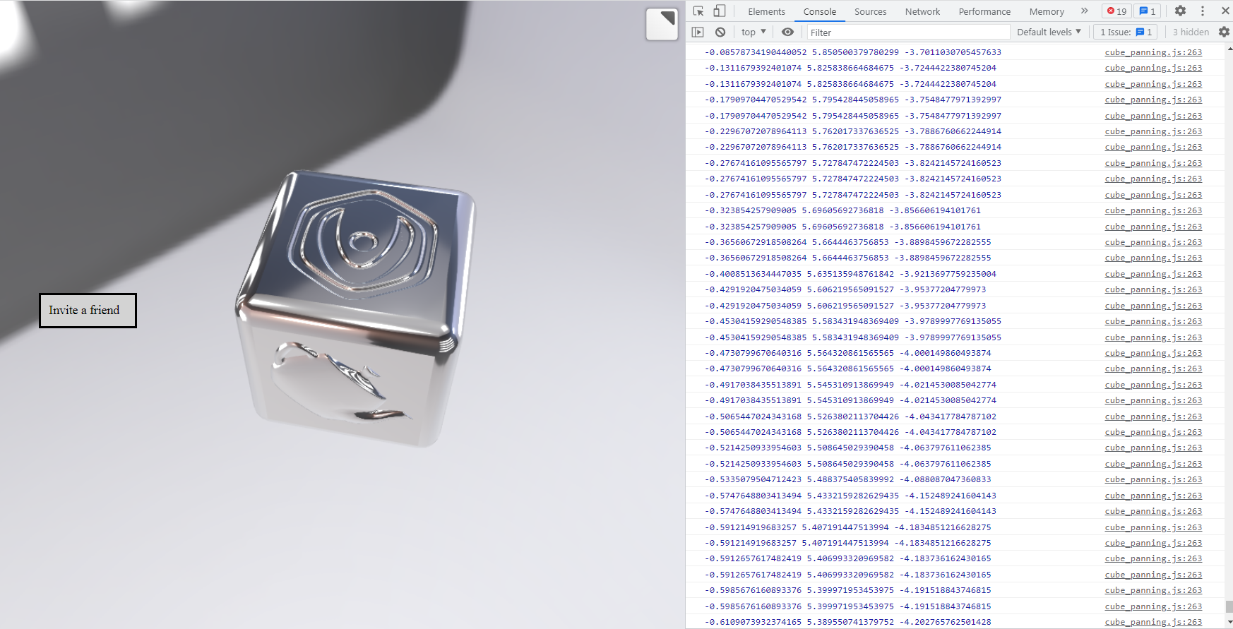

2022-07-26 at 4:25 pm #54421scatman2513
ParticipantYeah, I mean you can see that the x/y/z position of the scene camera is being transmitted without any problems. This has nothing to do with SocketIO.
I can even simulate this without sockets.io :
1. Log x/y/z position of scene camera without moving it (default position). I get the values 4.05/3.03/4.05
2. hold the middle mouse button (mouse wheel) and drag the object out of my view.
3. Log x/y/z position of scene camera. I get the values 0.64 / 2.75 / 7.67
4. Now create a puzzle and set the position of the scene camera to 0.64 / 2.75 / 7.67 after 5 seconds.
5. See the result. The Cube is still in the middle of the window and is not out of the window as it should be.

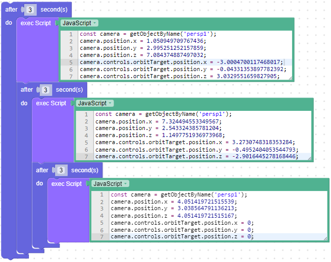

ParticipantYou should also read and transmit the position of
orbitTargetwhile panning.
https://v3d.net/9mbYou should read 9 parameters: the scene camera position/rotation and the rotation center position…
2022-08-29 at 3:37 pm #55342scatman2513
ParticipantYou should also read and transmit the position of orbitTarget while panning.
That solved my issue. Now its working for all movements with
