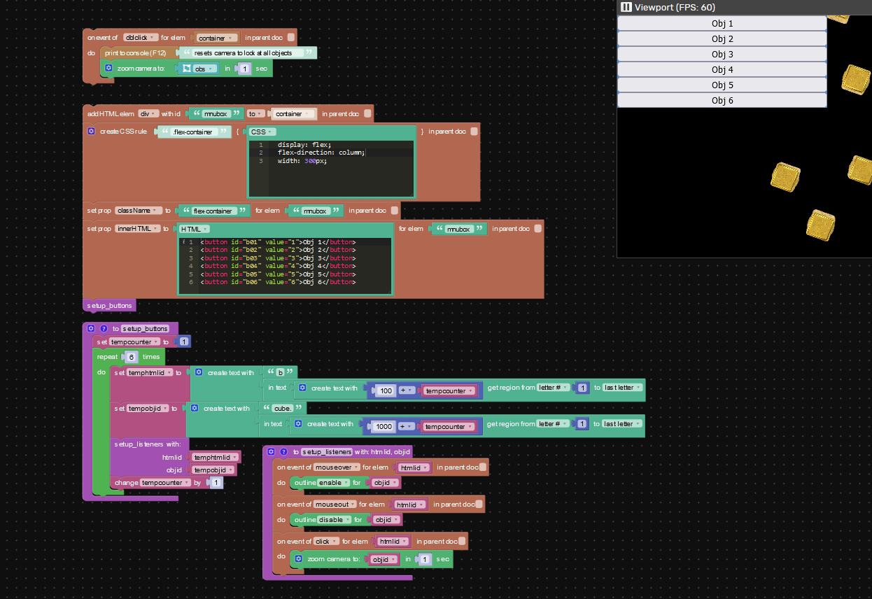

    Iterations are a bit tricky at first, but will save you buttloads of time.
    Here is demo of what I think you described
    https://v3d.net/9ul
    Notes
    *come up with naming (eg name + ###) convention for your elements/3d objects to make cycling through them easy.
    *I had put values in for the html buttons out of habit but aren’t required in this setup. HTML values are useful though as they can be picked up by with the onclick – ‘get event property: target.value’ puzzle. Just remember, DIVs don’t have the value property
    https://www.w3schools.com/tags/att_value.asp

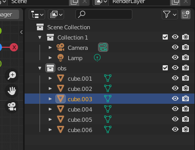

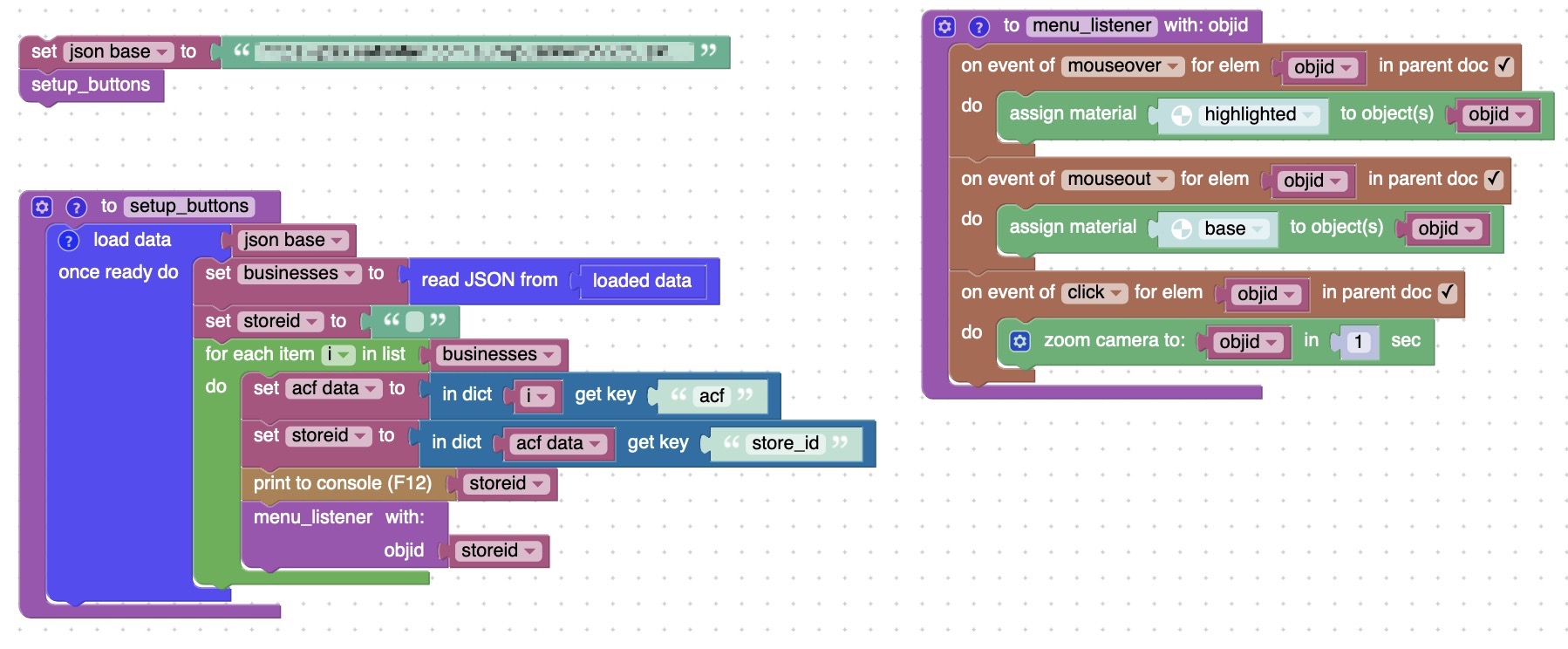

    I finally worked it out from your example Crunch. Thank you once again.
    I was able to take the json from the pages of the custom post type on the site I made to pull the store id in as custom field to build the list in verge3d then use the listener.
    This will save me heaps of time down the road so I dont have to build the puzzles for each menu item.
    I have attached a screen shot if anyone else has this issue.
