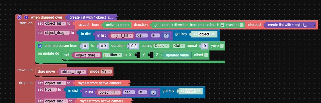

    I found that ‘Event dragged over’ behaves differently on mobile and pc, on pc it work as expected. As ‘Event dragged over’ have three action;
    -Start do
    -Move do, and
    -Drop do
    i found that on mobile it skip ‘start do’ action in the procces of touch, ‘start do’ only work when doing quick tap on the screen while two other action skipped, i try to combine with ‘Event click’ to substitute ‘start do’ action, but not working as expected too.
    Any solution for this? thanks.

    I also found that “when click” puzzles execute ‘do’ action at mouse down on pc, but on mobile its execute at touch up , so it giving different user experience on my app between PC and mobile

    OK, i found the problem is in “when click” not “when drag over” since i use that event at the same time (sorry).. So the tricky is, i use “when drag over” with ‘start do’ activated, to substitute “when click” so the action is execute at ‘touch down'(not touch up) similarly ‘mouse down’ at PC..
