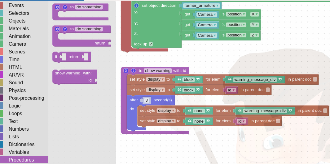

    Other issue, I didn’t find the puzzle : “show warning with ID” inside PROCEDURE

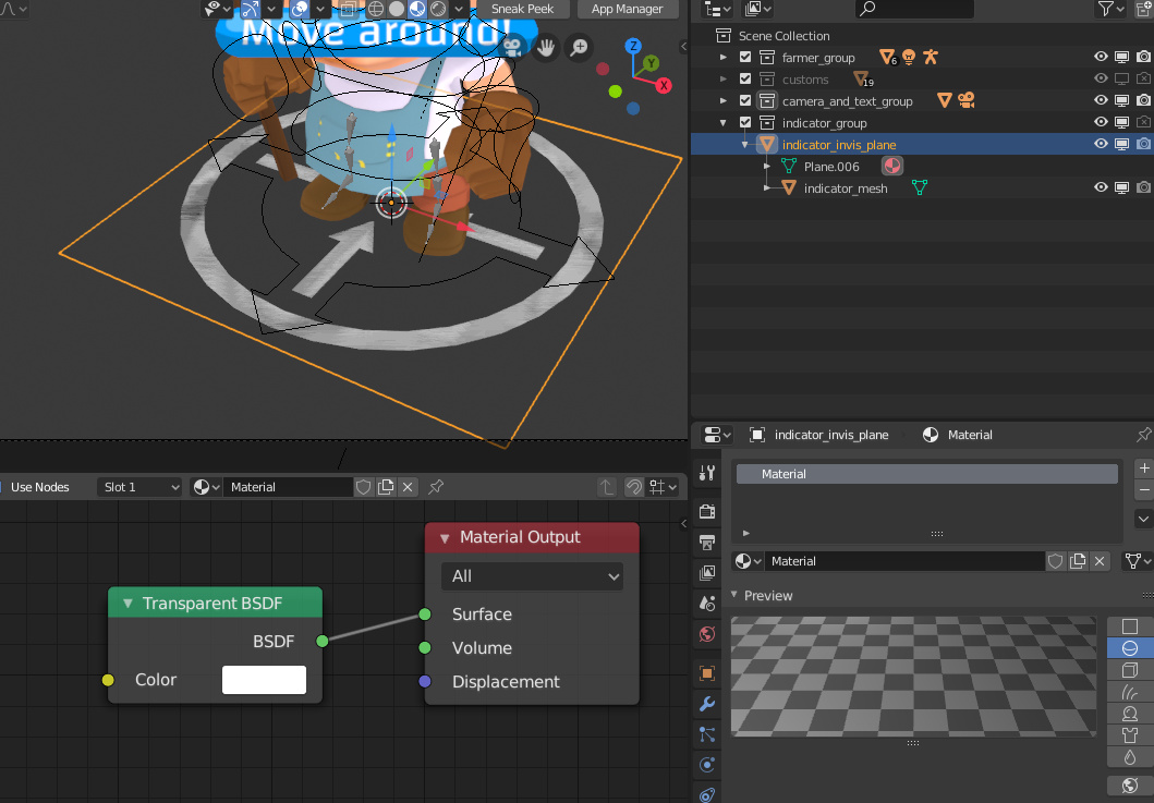

    And other question, I can’t imagine the objet : indicator_invis_plane , it’s a square mesh ? the blend file is empty. I have some difficulty to understand the puzzle and the relations between Blender
    #20588
    I should be there unless that procedure was deleted:
    #20590
    It is fully transparent:

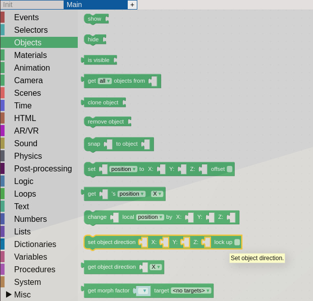

    #20619
    here it is:
    #20621
    it can be expanded with right click menu:
    #20623
