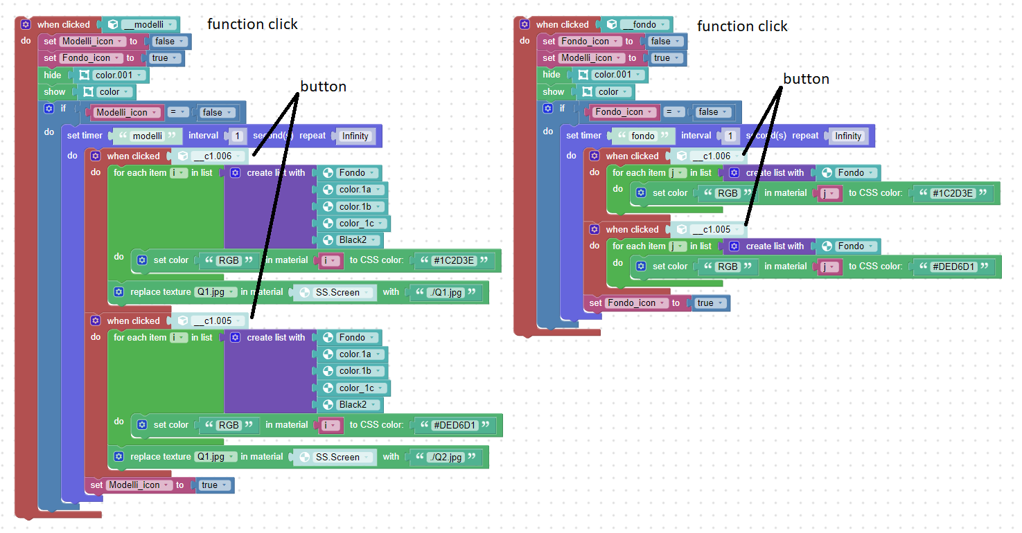

    hi, i have a hard problem that i can’t solve.
    I have created a keypad that should have a double use depending on the primary function selected.
    The function that controls multiple materials in the list overrides the second function.
    i would like to solve without duplicating ul buttons.
    Can anyone help me?

    Why do you use timers to register when clicked listeners? In your logic, once started, they do it every second and will never stop.
    Try this

    Thanks for the reply.
    i changed as you suggested, the problem persists.
    the problem is that both functions have the same link “c1.005 and c1.006” the “_models” function also surpasses that of “_fondo”

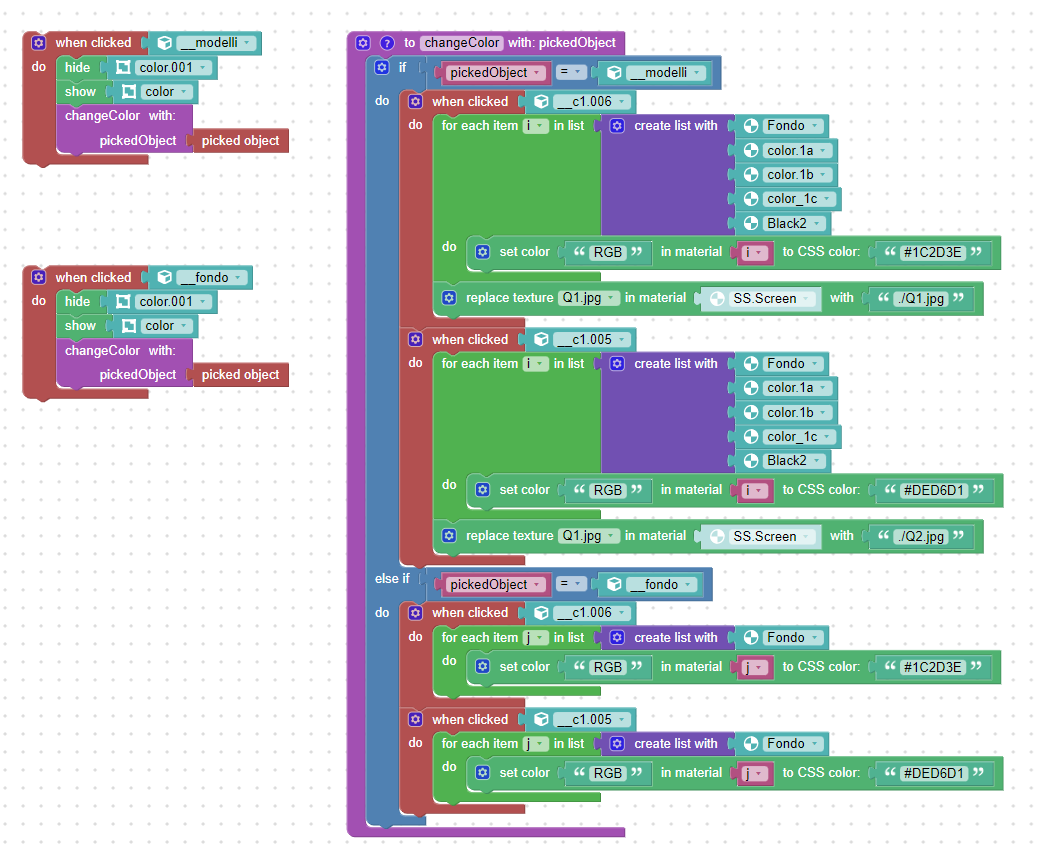

    thanks, i made another try, but when i add more material the commands overlap.
    the only solution I have left is to duplicate the buttons and give them different names.
    using the hide and show commands.
    thanks for your patience.
    #54806
    Well, if you’ve duplicated the buttons, you don’t need to register listeners for them every time you click _models or _fondo. just move them out, leave only hide/show puzzles.
