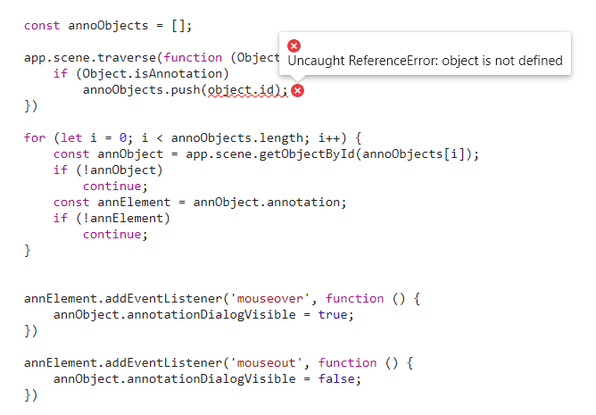

I have tried the code you recommend but I’m getting an error
“object not defined” (kindly check the attached img).
2022-08-02 at 6:23 am #54563kdv
ParticipantObject != object,annoObjects != annObjectsjust copy and paste ))) you have at least four typos. why do you change names of variables?

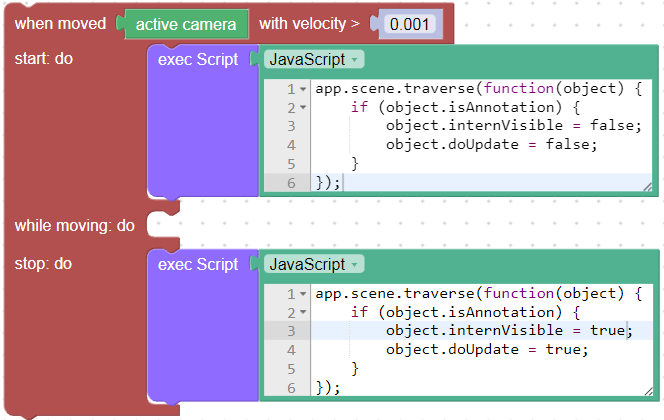

2022-08-02 at 11:36 pm #54592kdv
ParticipantSomethig like this )))
