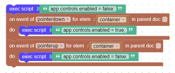

    Hi, I’m sure this question has been asked before but I cannot seem to find something conclusive. I have Verge3D being served to my visitors via an iFrame. When they hover over it, the parent page cannot be scrolled. How can I disable this? I’ve tried adding scrolling="no" to the iFrame html but that doesn’t seem to work .

    The issue is that I still need to control the scene with the mouse by dragging an object in the scene. I just want people to still be able to scroll nonetheless. What should I do?

    Hmmm, I don’t need the scrolling to navigate the app, but I do need to be able to click-and-drag the object inside the app to rotate it. That will be disabled if I choose “No Controls”. Do you have an example I can see of this in action? I’ve also tried adding overflow: hidden as a style to the iFrame.

    Try this.
    #52530
    or maybe this will help…
    in this case controls will be active only after a click or a touch…
