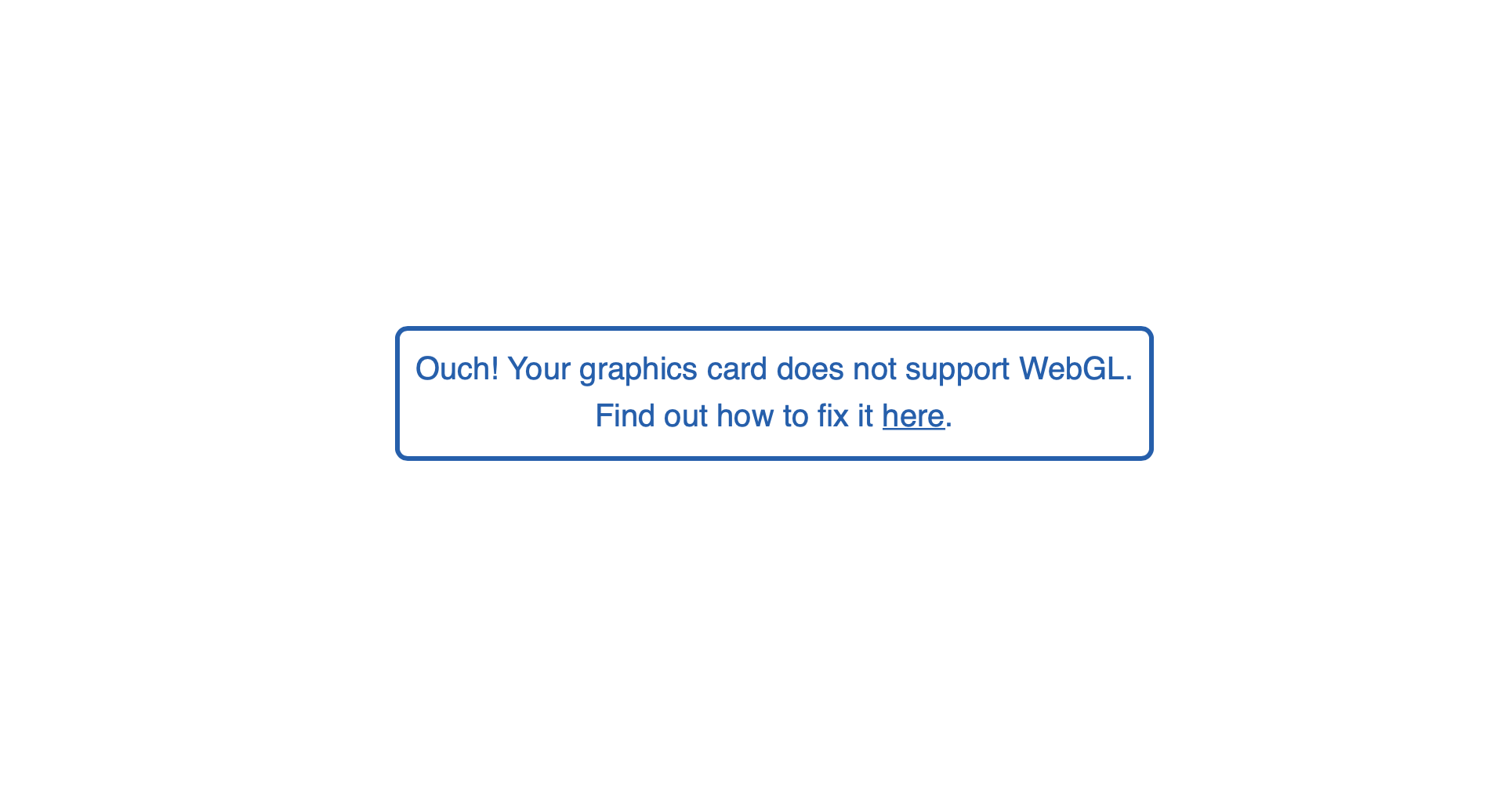

Tutorials - https://www.xeons3dlab.com2022-05-17 at 5:53 pm #52150ma77hew
ParticipantThis one here. I have it displayed after disabling WebGL in Safari. How can I customize this?

Tutorials - https://www.xeons3dlab.com2022-05-17 at 7:20 pm #52153
xeonCustomerOk…found it in the v3d.js file. You can modify the text and the link there. I am still digging around to find a more elegant way of handling it with a branded graphic etc.

Yuri KovelenovStaffYou can override the styles for this notice by using the following CSS classes:
v3d-webgl-error
v3d-webgl-error-linkYou can also override the content of this message (text and link). However, this piece of HTML code is only injected if there is no webgl.
So, to do this, in the
your_app.jsyou could try to obtain a WebGL context first.var canvas = document.getElementsByClassName('v3d-canvas')[0]; var gl = canvas.getContext('webgl');If there is no WebGL, retrieve the HTML elements of this message with getElementsByClassName and update with innerHTML.
