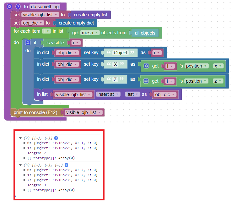

    Hello, I was wondering why I can’t create a list of dictionary values.
    When try to add existing dictionary to a list -> List prints out last dictionary value, for all index values.
    #55032
    Hi, you need to place “create empty dict” block inside the loop. Currently, you just set key/values for the same dictionary which is added to the list multiple times.
    #55037
    junglist
    Thank you, that fixed the issue. :good:
