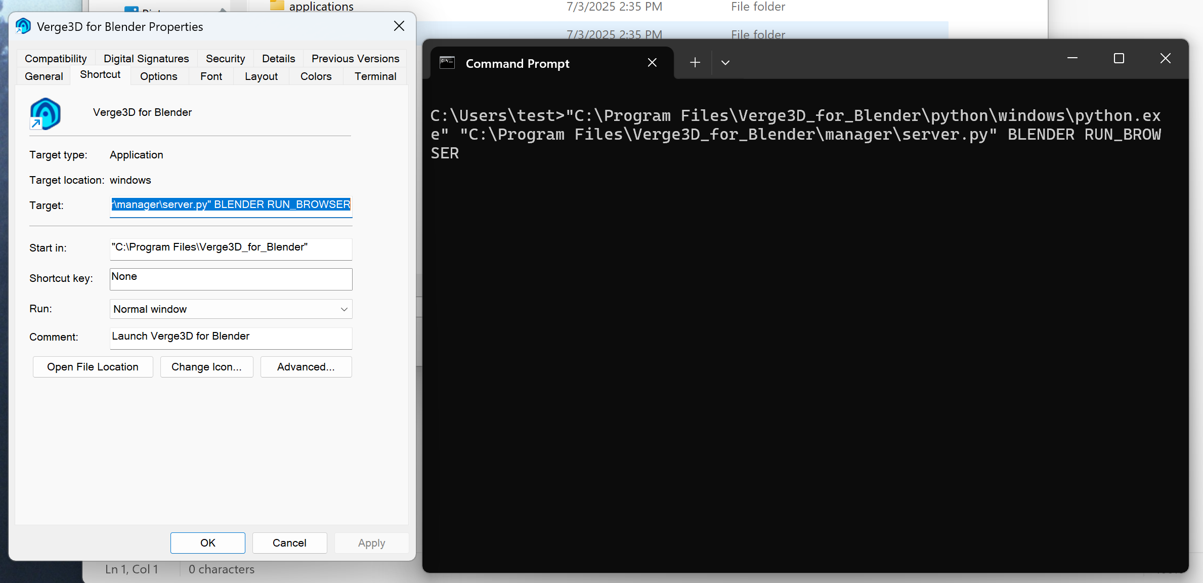

Alexander KovelenovStaffHi,
You can run App Manager in the already opened console window by doing the following. Right-click on the launcher icon, then click “Properties”. In the “Verge3D for Blender Properties” dialog go to the “Shortcut” tab, then select and copy the content of the “Target”.
Open the command prompt (start menu, then type “cmd”, then select Command Prompt from the list). Paste the copied “Target” content in the opened command prompt, then press Enter.
Once the error happens, please copy the entire content of the command prompt and send back to us.
Hope this is not too much trouble!
