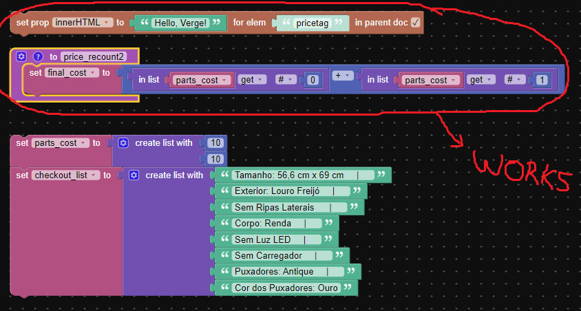

I’ve also attached a screenshot of the puzzles I’m trying to use at the moment.

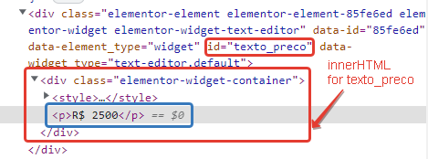

2023-10-10 at 12:55 am #67427kdv
ParticipantThe text I’m trying to change is the “R$ 2500” text
You are trying to set
innerHTMLfor the wrong element.
The element you need have no id. Read about
querySelector()and sequential requests or set some unique id for<p>.Puzzles and JS coding. Fast and expensive.

Thanks for the help once again.2023-10-10 at 2:38 pm #67449Brameister
ParticipantUpdate for future reference:
I set the ID “pricetag” to the <p> element in the HTML file and it worked when the Set Prop puzzle was by itself. It wasn’t working when it was inside the price_recount procedure created to update product price based on client selections in the configurator.
The reason it wasn’t working is because the procedure was set, but not called.
