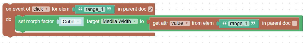

    I have attached Image of puzzles I am using for this function, but it is not working properly
    #35189
    you should also check “in parent doc” for the second puzzle.
    #35190
    May be there’s no value in Range_1 element> to understand try to print this value in the console. Or may be you just need to set in parent doc checkbox on the puzzle if it’s located outside the main canvas.

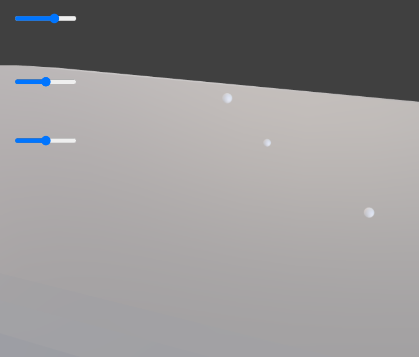

    Thanks for your response, I used print console. range_1 have exact values when “in parent doc” is checked for the second puzzle. But now when I move slider my 3d model get vanished from scene and at value “1” it somehow comes around me(camera). I don’t know what’s happening. do you have any idea?

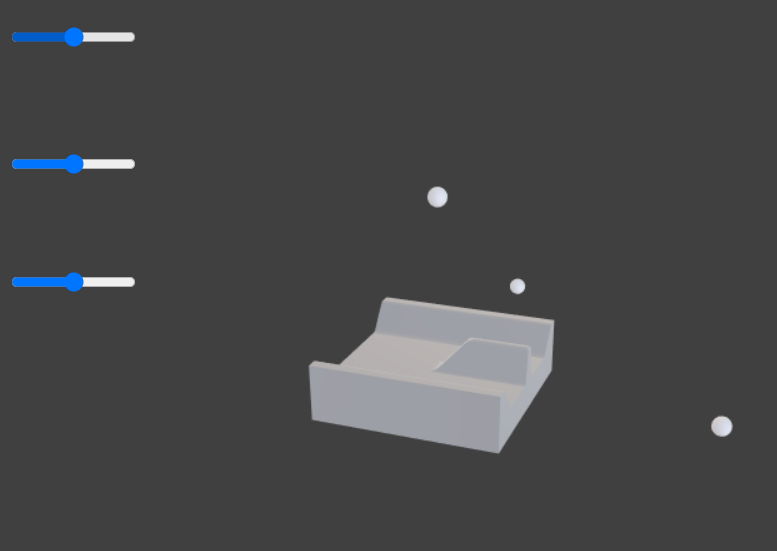

    i have attached 2 images. one image when value is 0 and other image is when value is 1.
