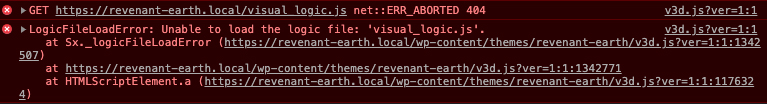

I’ve been trying to go through articles like the above and following a few tutorials, and I think I’m halfway there. I’ve enqueued the js script files in WordPress’ functions.php file, but my browser returns the below “Unable to load the logic file: ‘visual_logic.js'” error.
I’ve kept the file structure the same as the one V3D generates, and the other scripts are visible as having been correctly loaded when I inspect element, so I assume (possibly wrongly) that this is possibly due to it being called by this line in the main js file:
var logicURL = params.logic ? params.logic : ‘__LOGIC__visual_logic.js’.replace(‘__LOGIC__’, ”);
…in a way that WordPress doesn’t like?
Any help and suggestions massively appreciated!
Edit: to clarify, even though the error message is from a deployment on a local site, it replicates for me when tested on a live site, too.
2021-05-07 at 8:58 am #40840
Alexander KovelenovStaffHi,
Indeed, the app tries to load visual_logic.js which is located in the same directory where HTML (or PHP) file located. Change ‘__LOGIC__visual_logic.js’ to the actual path to the logic script, say
‘__LOGIC__/actual/path/to/wordpress/scripts/visual_logic.js’ -
