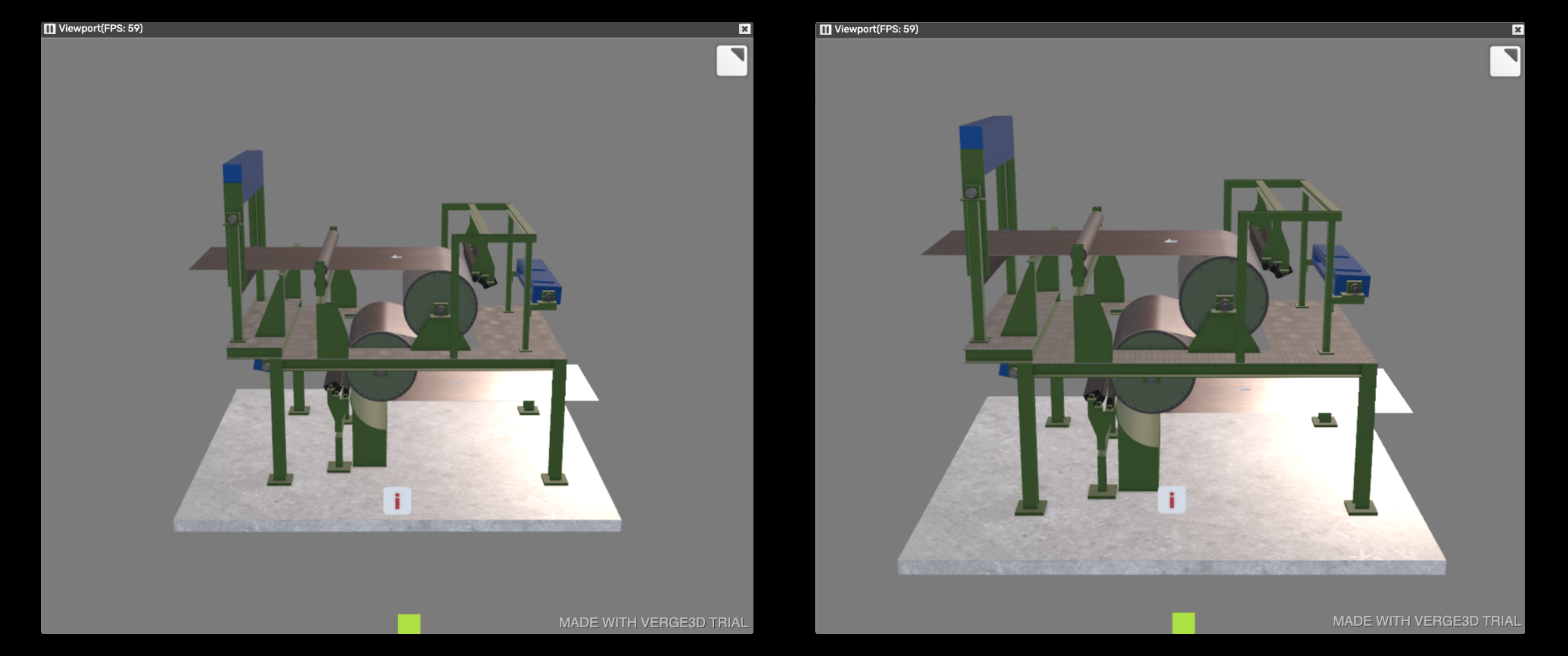

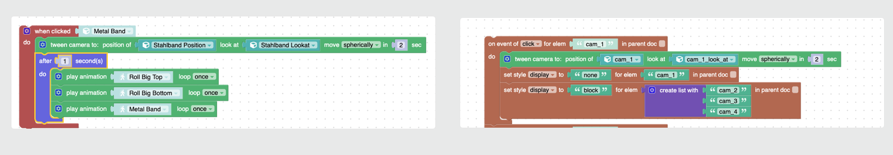

    I encountered my camera after it smoothly tweened to a new position to jump forward.
    asdf
    I looked at the puzzle demo file and manual but it seems I have it all set right

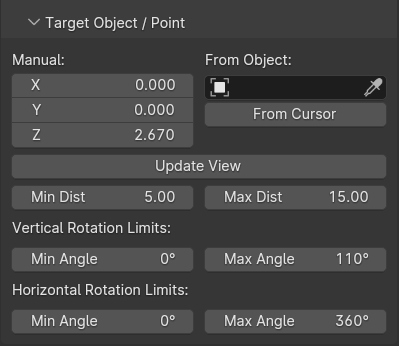

    I am curious if this is actually something from the camera properties – those that can restrict the movement

    Too
    Error 2 was it
    Makes sense now – I move the camera outside the predefined limits.
