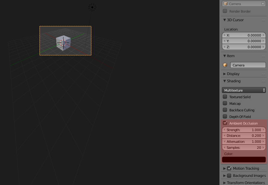

Mikhail LuzyaninStaffCan i somehow controll the “near and far” camera clipping planes, and is it possible to add some post effects ex. ambient occlusion.
Both are supported, you can enable SSAO with specific checkbox in the 3d viewport.

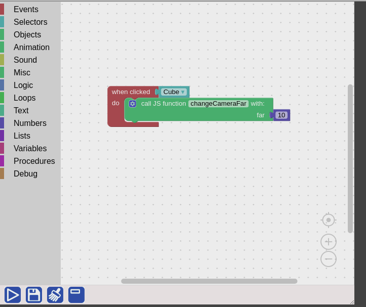

Ivan LyubovnikovStaffRegarding the clipping planes. In the documentation I can finde this line of code:
var camera = new v3d.PerspectiveCamera( 45, width / height, 1, 1000 );
scene.add( camera );How can I implement this code to my scene camera?
Hi, you can call the JS code for controlling the clipping planes via the “call JS Function” block (located in the “Misc” panel).
But you also need to define this function in the code, e.g. by editing the runCode method in the default .js file of your project like this:
function runCode() { // add your code here, e.g. console.log('Hello, World!'); app.ExternalInterface.changeCameraFar = function(far) { app.camera.far = far; app.camera.updateProjectionMatrix(); } }Attachments:
2018-03-01 at 8:24 am #2585David
ParticipantThank you for your help Ivan, it worked out great, and good to know how the “call JS function” works.
