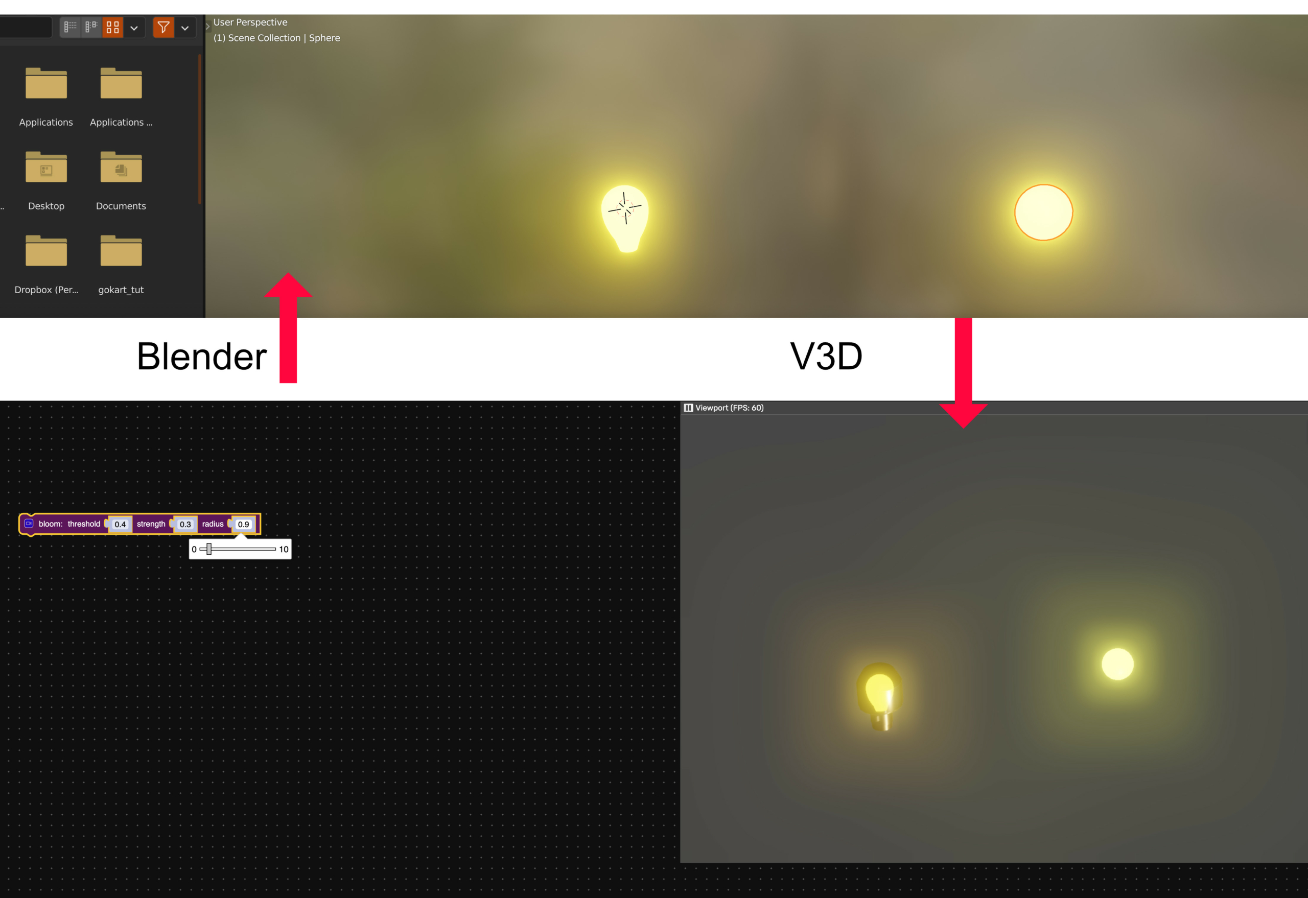

    Is there a way to have the bloom glow match the outline of the mesh object rather than a square?
    I don’t recall this being an issue in 3.9.1.
    #57196
    Can you send us a sample file? We are not reproducing the issue with our own scenes in 3.9.1.
    EDIT: I mean it renders the same squarish stuff in 3.9.1
    #57201
    3.9.1 Sample: https://webgl.r66dapps.com/starpuzzle/
    Emissive object is a bulb in the light above the table. The color may hide the effect though.
    3.6.0 Sample: https://www.r66d.com/p51
    Emissive objects are glowing orange balls. Although here they appear squarish – with slightly rounded corners….still better than what we have now.
    #57254
    Thanks for the links, although those are different apps which are difficult to compare with each other directly. I wonder how a same scene would look in older Verge3D and now.
