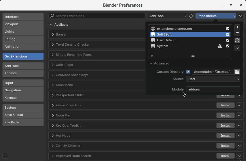

I am have repeatedly followed the extension linux installation instructions for Blender 4.2
https://www.soft8soft.com/docs/manual/en/blender/Installation.html#Installation_for_macOS_or_Linux
on 2 Rocky linux machines but the extension is not seen.
Is there anyone out there who has succeeded? Am I missing something ?
Thank youAttachments:

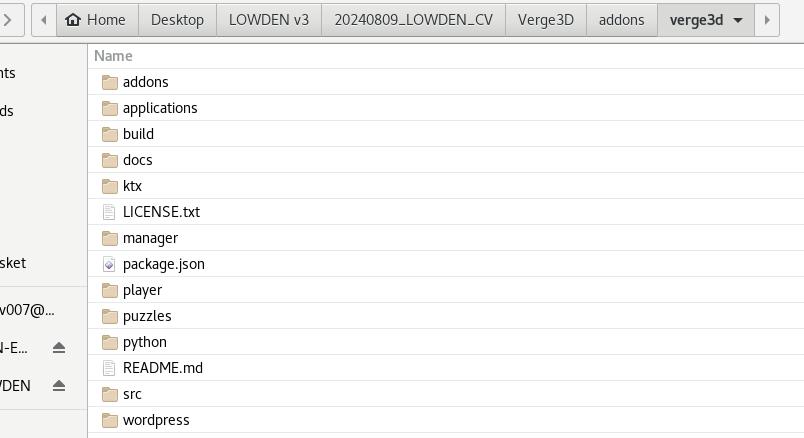

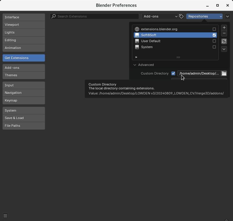

ParticipantI’m installing 4.7.1. Verge3D does not show up in the add-ons tab. Attached are screenshots of the add-on path

I have a similar problem on Win11 after many tries. I have installed Blender 4.2.3 LTS (while 4.0 is still also installed) and Verge 4.8. I added the local repository pointing to C:\Users\name\verge3d_blender\addons\ and refreshed but the Verge extension does not appear in either the installed or available. The addons folder has two sub folders .blender.ext (which is empty) and verge3d that has 15 files and two folders. Nothing appears in the Add-ons tab either.
