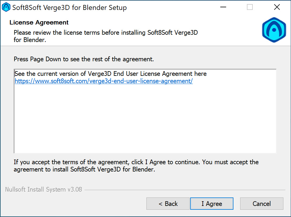

    Follow the link to read the recent version of Verge3D license agreement.

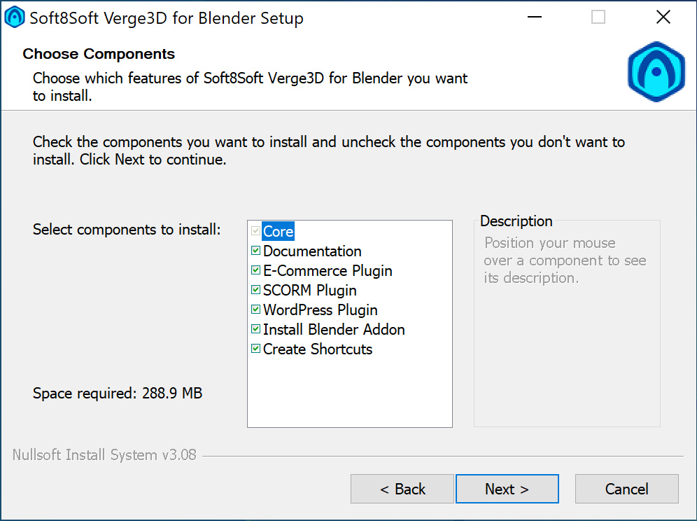

    Choose components you want to install.

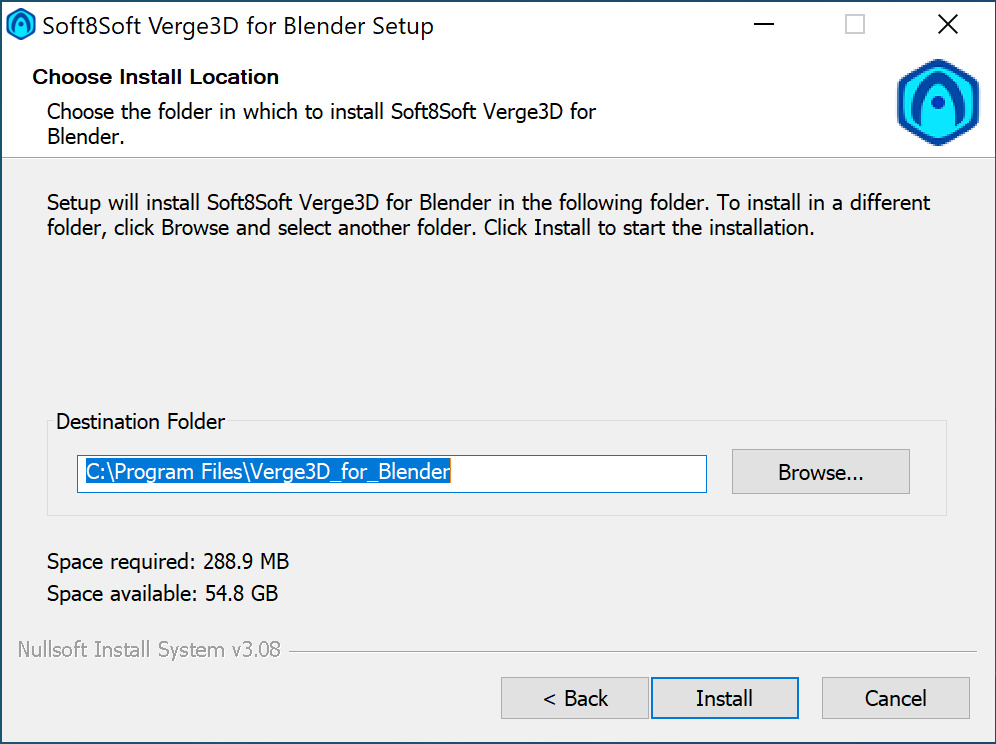

    Now choose an installation folder that have enough permissions for reading and writing (or better leave it by default).

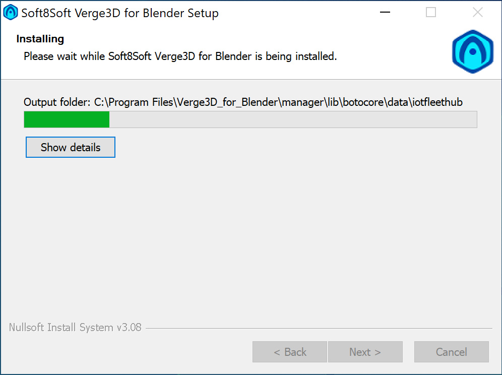

    Wait until the installer finishes copying files to the target directory.

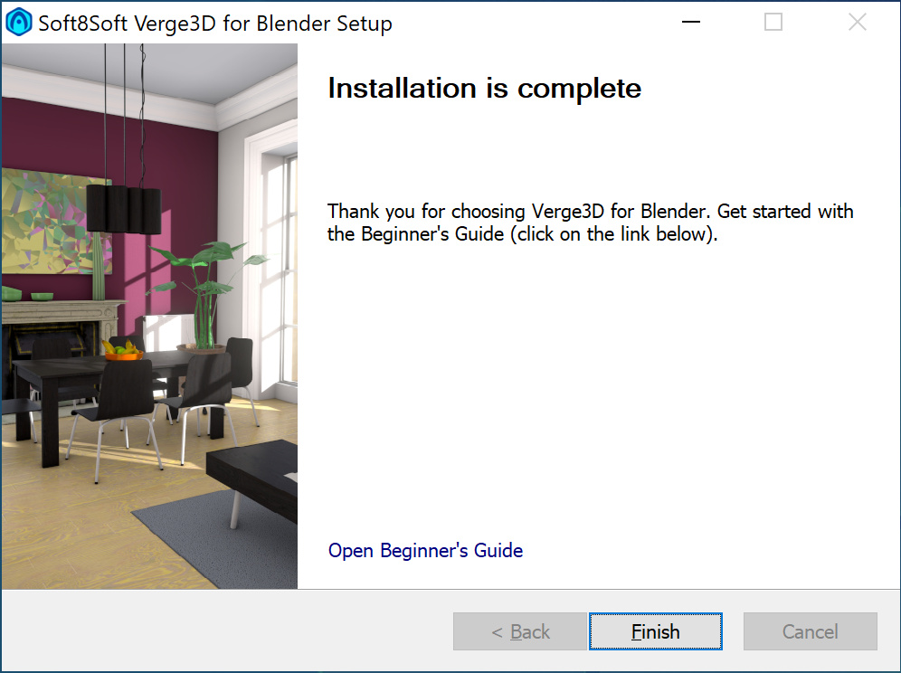

    Once installation complete you'll see the following screen.
    Press finish and launch Blender. If you had it running, be sure to close and open it again.
