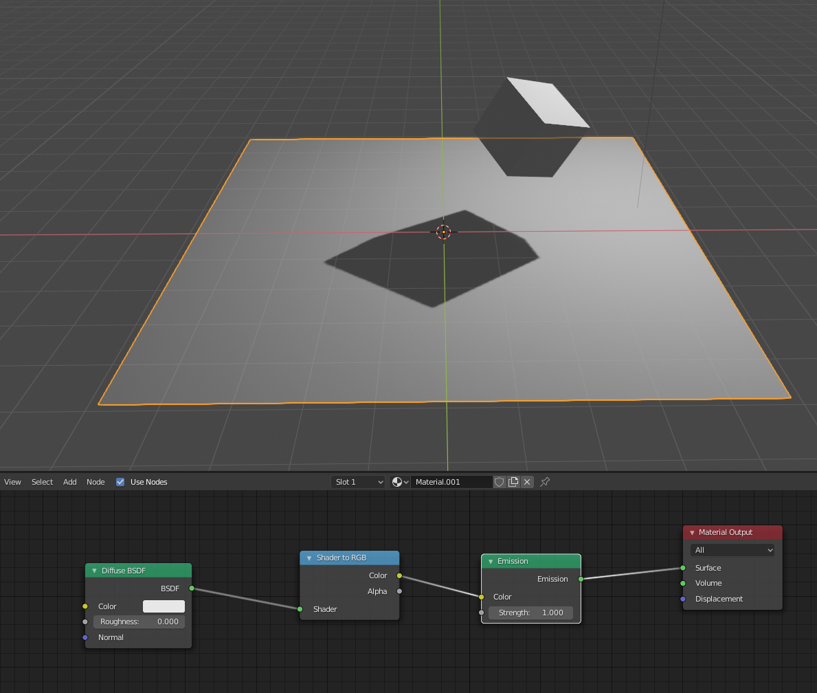

    #16629
    emissive material -> receives shadow
    Unfortunally directly no, but you can create a Shadow Catcher using Shader to RGB node.
