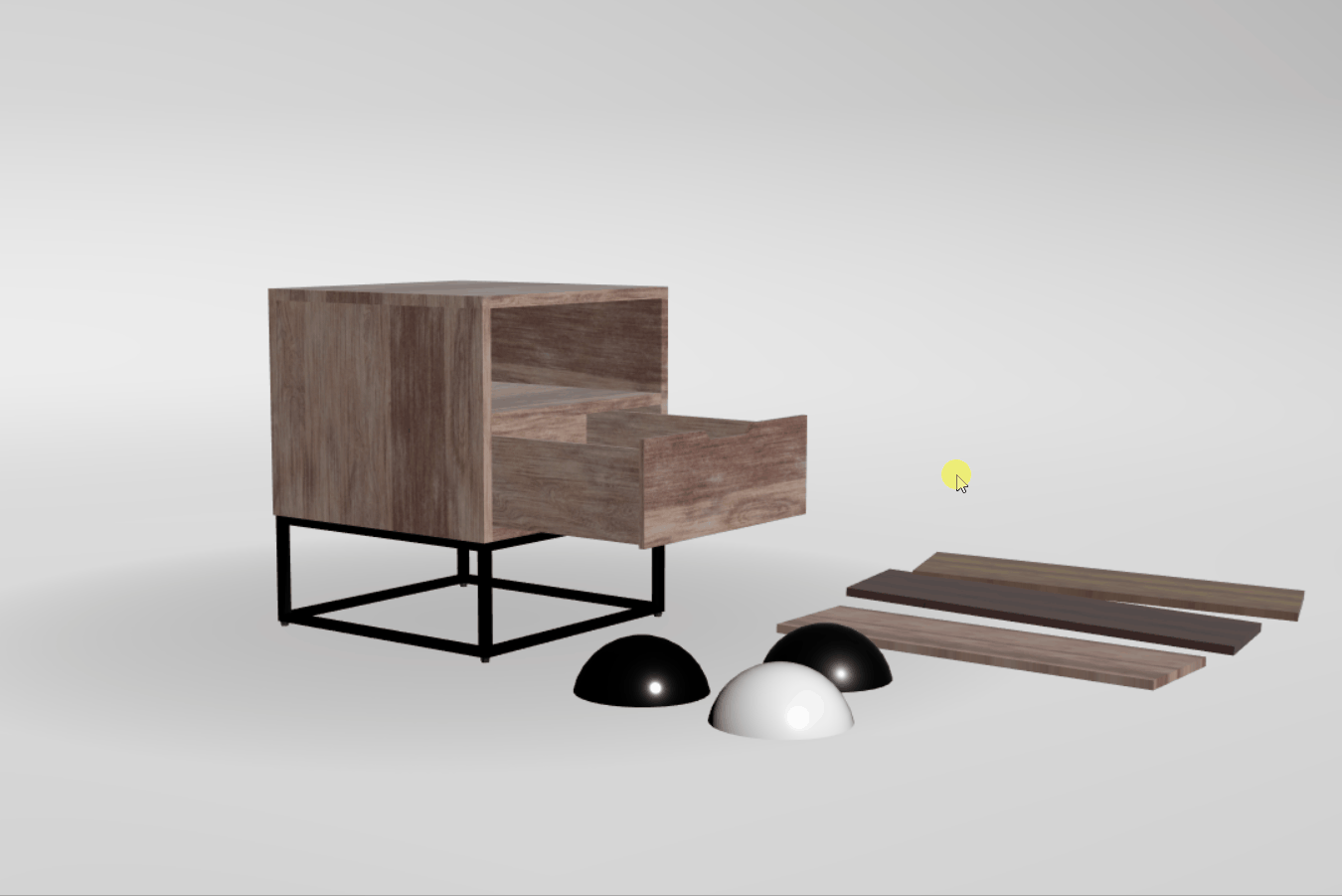

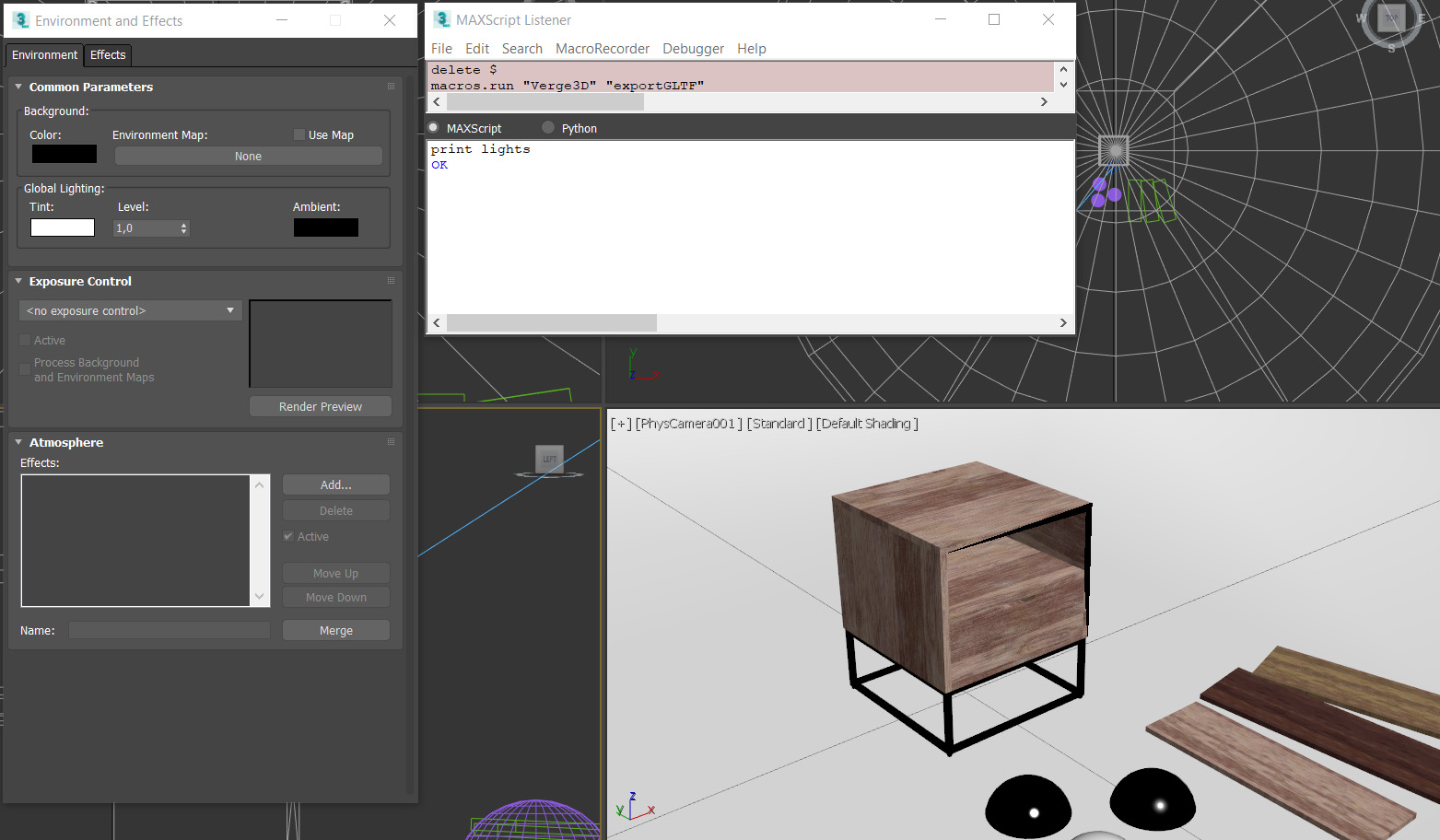

    zeitgeist
    Hey,
    I also need some help with shading.
    I try to get a neutral white lighting for my scene, because everything is baked already and ran into the same issue.
    If I delete all the lights and set the Environment to black, shouldn´t the scene be completely black?
    For easier explanation I´ve used the “simple-configurator” demo.
    I delete the lights and set Environment to black.
    This is the result:
    Where does the light come from and why does the left side of the drawer turn dark?
    #32567
    this is a normal behavior since if you delete all lights, a default one is added automatically to the scene. To remove all lighting, you might use completely black Environment texture, or alternatively set the intensity of the light sources to zero.
