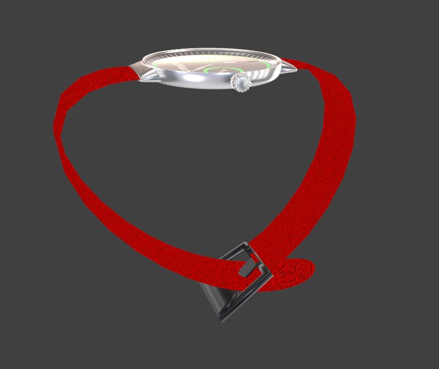

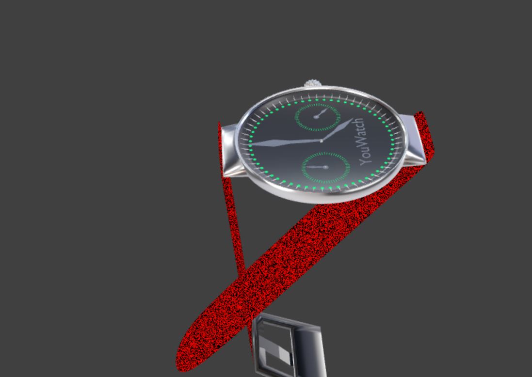

    Can Verge3D work with Blender armature type “bendy bones”?
    Because I have a wrist watch animation which closes the watch band.
    In Blender it is working, the band having a smooth curve. But In Verge3D it seems only the band endpoints bones animation it ‘imported’.
    So the watch band becomes straight, not good.
    Below attached the curved band from Blender animation.
    And the straight band in Verge3D. How can I make this curved as well?
    #46564
    No, it’s not supported. Use multiple bones with IK instead.
