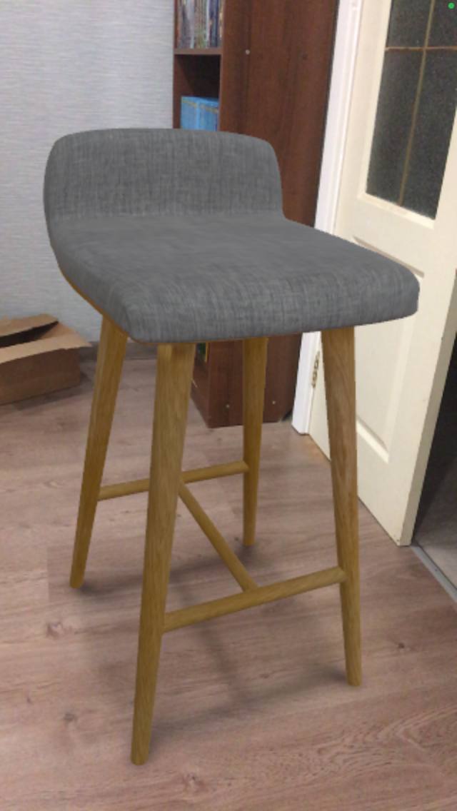

    I start a new project with VERGE 4.4.0
    AR working on Android, but not on iOS (the button not working)
    I use exactely the same puzzle that Augmented Reality Demo (I test the demo on iOS and its working)
    Here my test : https://v3d.net/mo7
    I upload the file .usdz and its working
    I can’t found the problem, someone can help me ?
    Thank
    Best regards

    It was an old good iPhone SE (specially for tests in iOS) with iOS/Safari 15.7. It was working yesterday, it’s working right now. See no difference.
