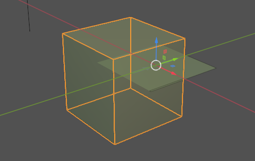

    #66539
    In blender the origin of my object is in the top-face-edge.
    But in AR the object gets place with the middle-back-face
    Because the origin of your cube is actually in the middle of the back face.

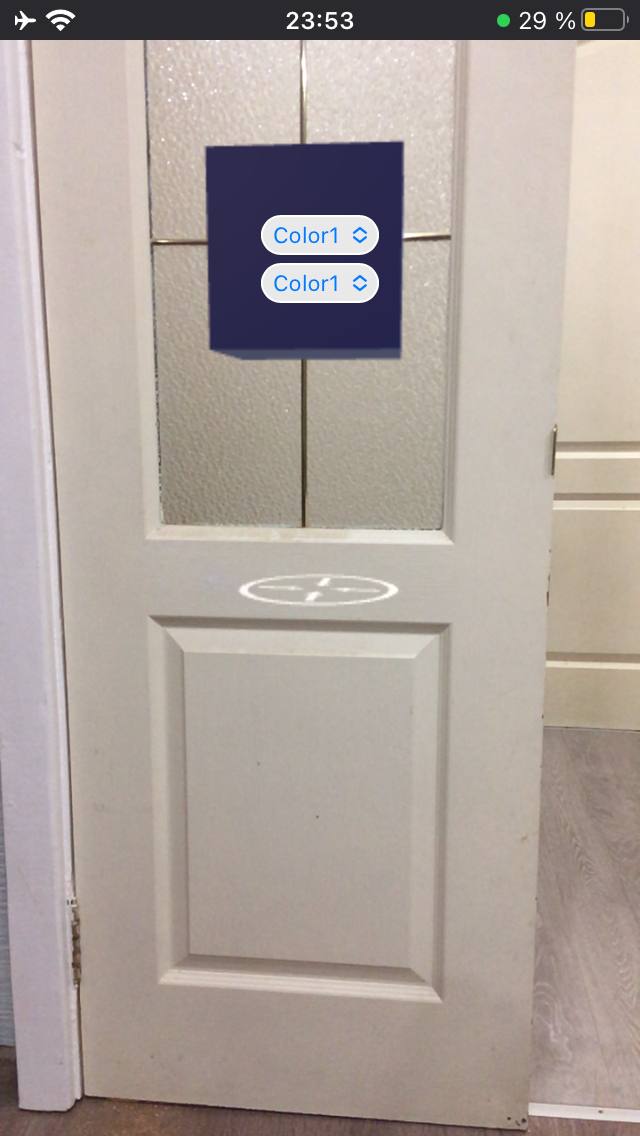

    But I notice 2 things in the view
    1. when I tap the “cross-circle” when it is on the wall, the cube is made visible but too high. I set the Z to” floorcoordinates+1″. So it should be at 1 meter above the floor.
    2. the cube is slightly turned in Z-rotation. So it is not parallel to the wall. And also a little scaling issue cube to small/large for room dimentions.
    Maybe it is the cross-circle function I am not using correctly on the wall.
    On the floor with the farmer app the cross-cicle is placed on the floor, you tap it, the farmer is placed.
    So I gues with the wall, when the cross-circle is placed against the wall, you tap it, the cube is placed. But it has z-rotation, and is to small.
    For some reason the cross-circle has trouble finding a right scale, it is getting smaller/bigger while scanning the wall and floor.

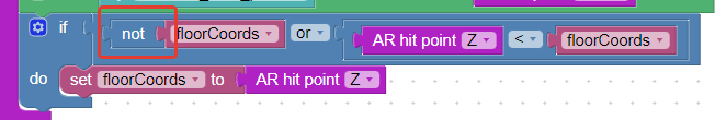

    Here’s your mistake
    Correct condition

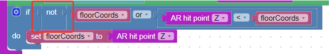

    #66576
    vision
    Correct condition
    Ahh, I see, thank you, the height now works!

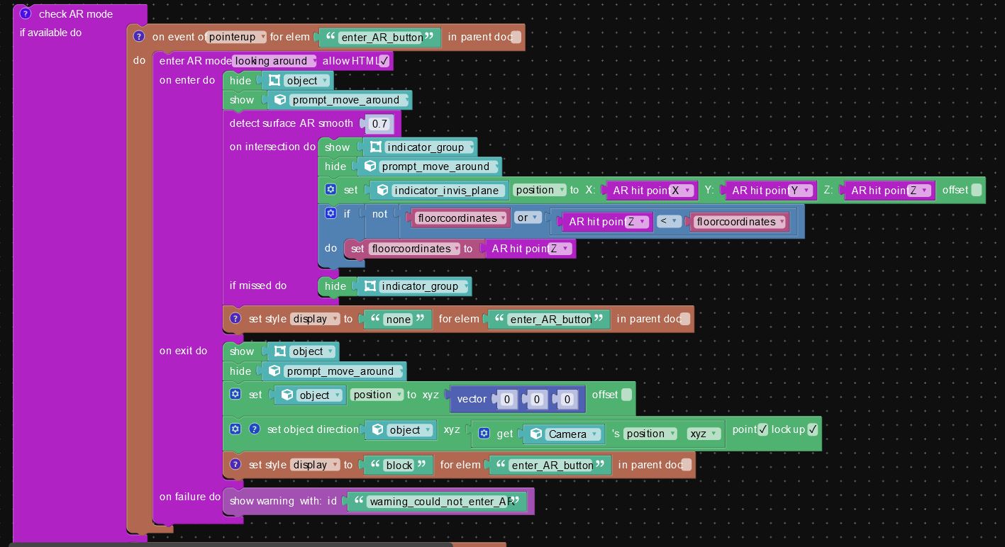

    When detecting wall the pointer should rotate
    Without you code this poitnter will do nothing.
    #66584
    vision
    the problem is my object is not clinging to the wall like the farmer in your example. Thats why
    I think my wall surface detection is not working. Strange but true…
