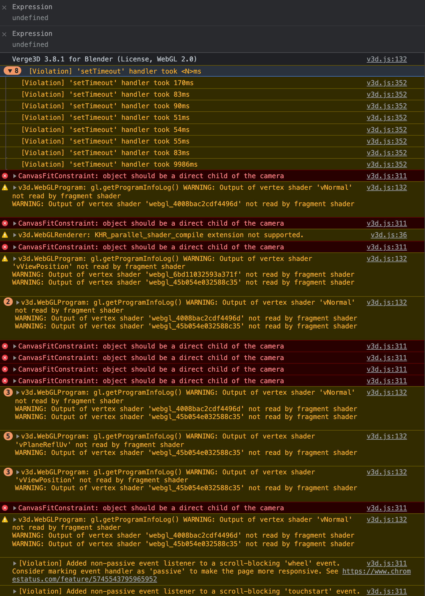

xeonCustomerTake a look at the Dev Console in Chrome.
The scene actually loads for me in under 8 seconds but the number of errors it’s throwing is causing mobile phones to choke.
Your biggest issues are the errors and warnings that are being thrown and your texture load times.
“CanvasFitConstraint: object should be a direct child of the camera”
is your biggest problem. You have at least 1000 or more errors on this issue.You have some undefined expressions that need to be cleaned up.
Your textures need to be optimized…some are taking 4 seconds to load…take a look at the file size vs load time.
Start with your basic blend scene and export that to Verge and see if you are getting all the same errors. If so, you will need to dig into the scene to see where things have gone wrong. You probably have a number of incompatible issues going on. Materials are often the starting point.
If its clean…then you CSS/HTML/javascript will need to be gone through to determine where the issue is.

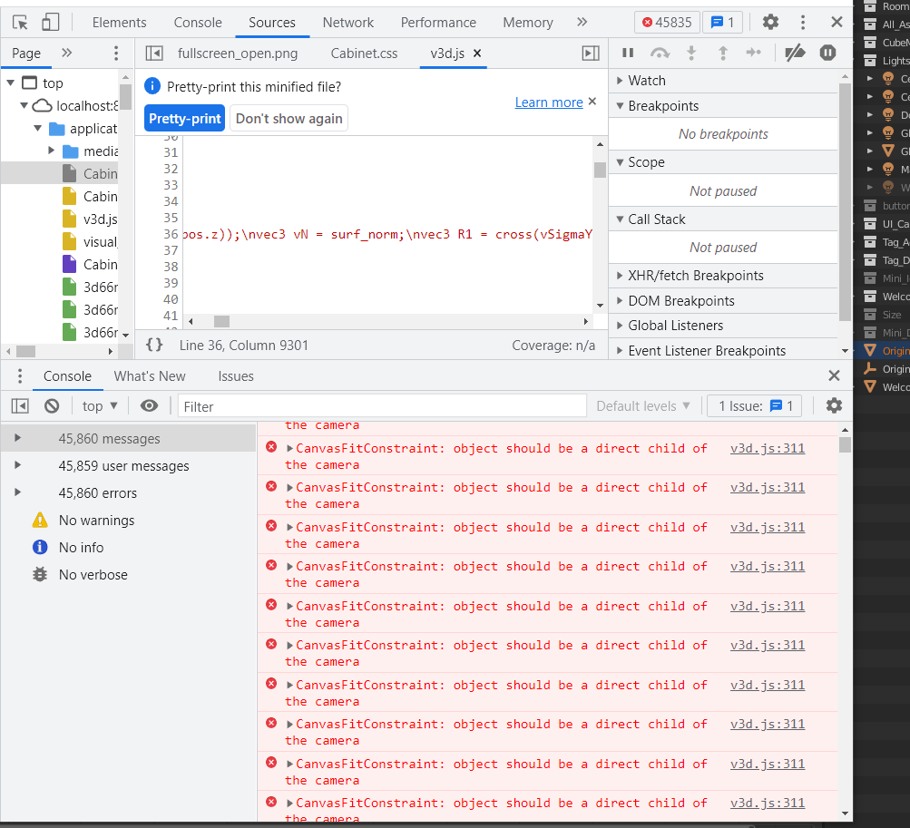

CustomerAnyone knows what happening……….
Errors msg still raising…..Attachments:
